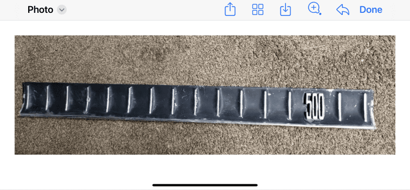

Hi folks , I have recently found a trunk finish panel for my 68 Coronet 500. I am going to restore it and would like to know anyone’s experience on methods used. I have a buffer for the metal. I am not sure on how to go about exposing the ribs after painting. Tape off before? Paint it all first and buff the ribs? Was the inside of the 500 red? Thanks for any ideas..

Hi TT, I did complete this project and so far am happy with the results. I bought 2 rolls of painters tape. 1 roll 1/4” wide, the other 1” wide. Sanding is next. 400 wet and 600 wet. I rinsed it off in sink to clean it well, then wiped it with tack Cloth. Get all the paint you can off. Even paint remover works well. I would advise against having it sand/ bead blasted. Once you have the panel where you want it, it’s time to tape. I cut 1/4” in tape into equal length strips and took scissors and rounded the edges a bit just to take off the sharp edge of the tape. I think 3 1/2” long each. I left the 500 emblem on but taped it off as you can see in photo. Once I got it taped off to my satisfaction , I bought some “ etching primer” hit it with 2 light coats of that. Let that dry over night I then sanded again very lightly with 600. Fixed any tape issues from sanding and was ready to paint. I used a matte black automotive lacquer. Once dries pull the tape, then I used a red touch up pen with the needle in the end. Layed it flat and let the red paint run into the 500 emblem. Another 24 hour dry, and it was ready to install. Biggest advice, it’s like any other paint project , prep is everything . More time spend on it the better the outcome. Also I did the R/T tail lights. Taped off the chrome outsides, repainted the silver inside portion of bezels. They turned out hood too. Here are some pics good luck TT!!
