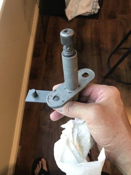

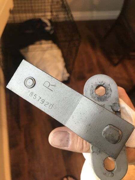

Restoring my wiper mechanism in the right side mechanism is frozen solid. Anyone know how to get this apart or fix it? If not does anyone have a right side available for a 69 super bee? Looks like part number 2857920.
Lube the he'll out of it... try rotating it slowly with a wiper arm connected to the spline shaft... maybe a little heat will free it up....
Agree with cheesehead guy:)
I have had them solid and been able to save them. Pbblaster or Kroll.
Acetone and transfluid
I drill them and tap them with a zerk fitting and lube it up. Has not failed yet, just like the wiper seal replacement kit has.
