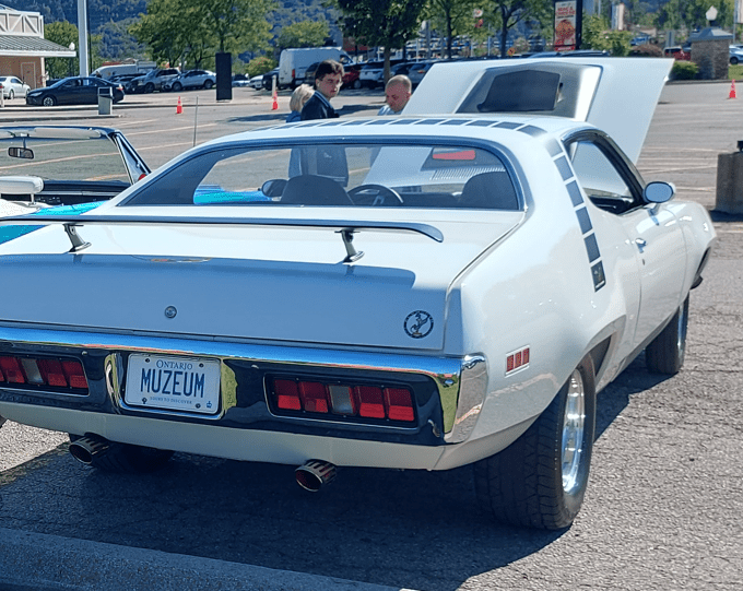

My Road runner has a 275-60-15 BFG tire on an 8" Weld rim with a 4.5" back space.

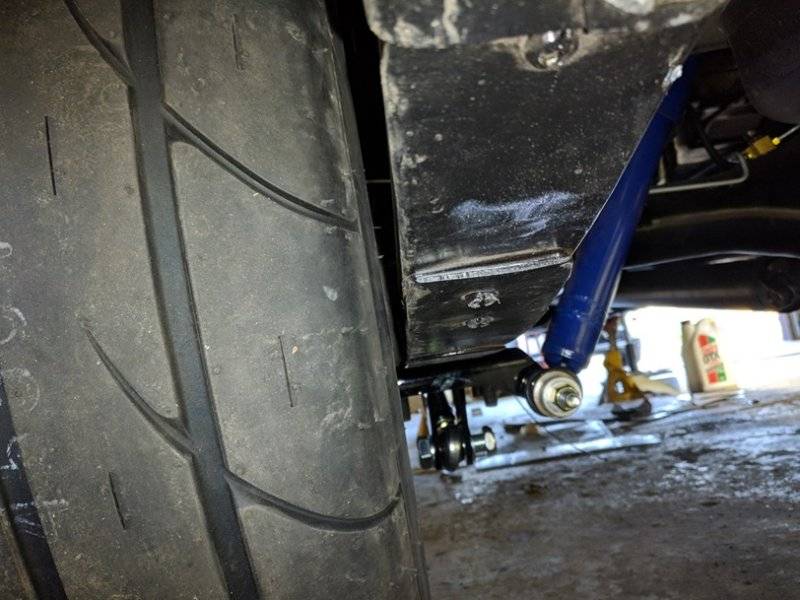

thanks for the info .i have 8 inch rim with 4 1/2 inch backspace now but very close to leaf spring in front about an inch
