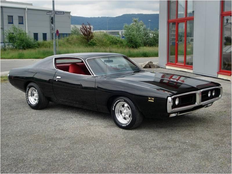

Next picture is a black 71 owned by Monkele on this site. It has 15x8 w/ 4.5 inch BS and 245/60/15 on the front. The rear has 15x10 w/ 5.5 inch BS and 275/60/15. The wheels are Centerline Legend Series Retro

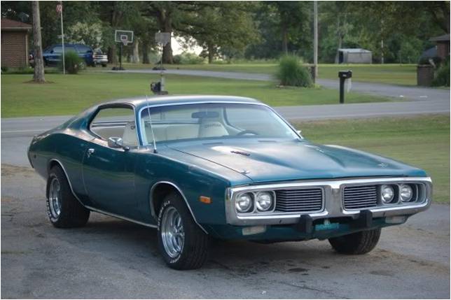

The next picture is a blue charger owned by Jaak on this site. 15 x 8 Crager S/S with 4.5 inch backspacing on the front with 235/60/15 (Tires were Futura GLS (?) Sport) The Rears were 15 x 10, with 295/50/15.....I cant remember the back spacing on the rears, but for me wasn't enough. The rear wheels slightly stuck out from the wheel wells, probably needed another inch of back spacing....would have looked perfect.

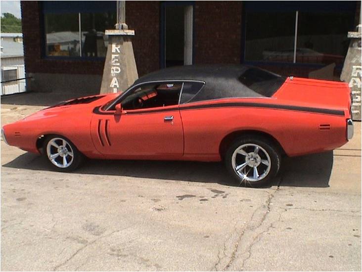

One of my favorite looks is the last picture is of a car I ran across for sale - an orange charger with Stockton wheels. Stockton is out of business and the wheels are not avaliable unless you can find stock on hand at a former distributor (I have tried but can not find the 20 inch anywhere). The front set up is 18 x 7 4-1/4 Back Spacing – Rim Width 8 with 235/40/18 HankookVentus V4 ES H105 – Section Width 9.1
Rears are 20 x 8.5 (4 ¾ or) 5-1/4 Back Spacing – Rim Width 9.5 with 255/35/20 HankookVentus U4 ES H105 – Section Width 10
If anyone has a set of these 20 inch Stockton wheels for sale I would like to buy them.

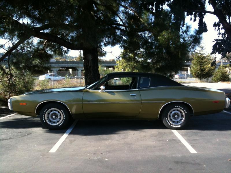

Just went through this process myself... people on this board were very helpful in steering me towards the right wheels & tire size.
I ended up ordering 15 x 7 Mopar Rallyes by Wheel Vintiques from Summit Racing, and running Cooper Cobra 225 70 15's on all four.
Very happy with the wheels, the look, the handling. Good luck in your quest!
