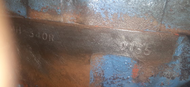

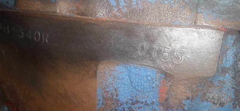

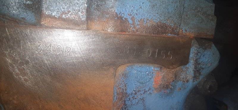

I'm new and this Road Runner is new to me. But I'm not new to Road Runners. So here is my dilemma. The VIN is RM21G4G the fender tag also qualifies that. The motor however clearly reads 340. To be more precise, it reads MH 340R the following numbers I believe are 38480155 get a little hard to read (see photos). I have had this vehicle for 18 days. Finally freed up a place in my shop for a few days to do some inspecting. I give the frame and body 8 out of 10. All rubber bushing are um... not good. A lot of original stuff under there still.

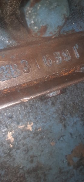

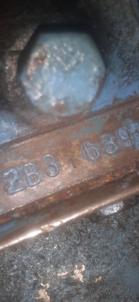

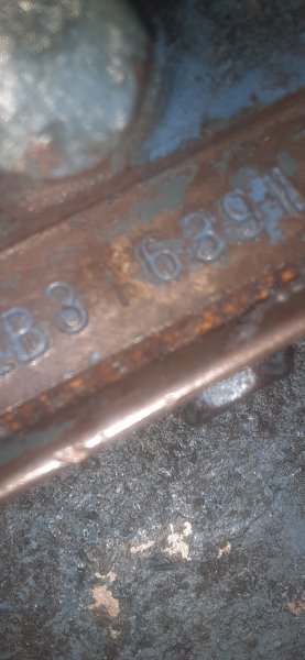

So I moved on to drive train. Not all that experienced with SB MOPARs but it didn't look like the 318's I've seen before. Indeed on closer inspection it is in fact a 340. If I'm gonna have a SB it's my opinion 340 is the better of the 3 after 68 up to 1971 ish. In the photos are numbers under the left head on the block and the machined surface at the oil pan on lower right side of block, just behind motor mount.
I am not sure how to read them to figure out year and what the motor may have come out of. Any help in deciphering would be greatly appreciated. Engine VIN 2.jpgEngine VIN 10.jpgEngine VIN 12.jpgLower Block VIN 2.jpgLower Block VIN 5.jpgLower Block VIN 7.jpg
On the side of the block will be a casting date and it will be 'cast' on the block and not a machined pad. Don't recall what side it will be on though. Also, the poly teen looks way different but from 67 on, they look just like any other small block. And welcome to the site!!!
Most likely from a '72 Dart, Demon, or Challenger built at Hamtramck.
I get the "Hamtramck" and "R" regular fuel. How do you get to 1972? I am confused on the number sequencing and which ones to use.
I also thought that part of the number at the bottom would match part of the number on the top.
Look at the raised casting numbers on the side of the block that will clearly tell you what displacement it left the factory as, not any stamped number

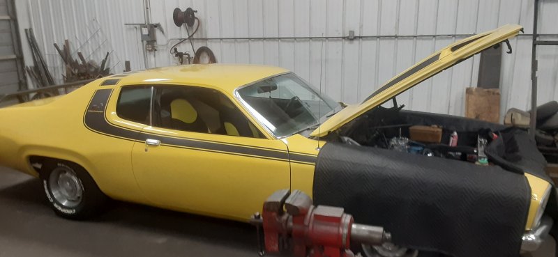

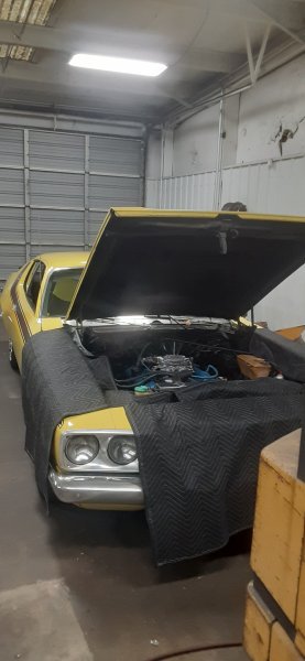

Okay, so the effects of "I got a Road Runner" liquor I drank wore off Friday evening and Saturday. Sure I went to bed with an 8 but seems that I am waking up with a solid 6 maybe 7. This girl is easy to look at and even a few strangers have whistled. But you start taking her clothes off and time has taken it's toll. Not sure yet what the hell is going on ignition wise. Tickled the carb a little bit and played with the timing and still can't get her to smooth out. You load her up and she stumbles and coughs and lurches. So I started with a compression check. #2 was the best at 150 lbs. While #3 & 5 were the lowest at 135 lbs. That puts me slap on the 10% mark. Ran all 8cyl. 3x's, very consistent. Just for giggles I let it set the 2nd and 3rd time and only lost 2lbs max for any one cyl. I know this is not a proper leak down test, just quick and dirty. I check the wires, good continuity, put a set of new plugs in her and still rough as sand paper. Yes I checked and double checked firing order. So I'm leaning towards ignition system. This is my nemesis. Like most other normal people I HATE ELECTICAL. I'm not sayin you ain't normal if you like that stuff. I'm just sayin you ain't right and god bless ya cause the rest of us need ya. Did I mention the puddle of tranny fluid (not that kind) on the floor after all the cranking and running in my shop. Yeah there's that. But hey it's still a Road Runner with good compression and that's not a bad starting place. What I need is a constant flow of money and no job. Being thirty years younger would help also but I'd settle for the free money.
Guess what, that 904 ain't no slouch. Just ask my buddy who'd raced a 360 Cuda with a 904 for years. Give it a beef up when you're ready and it'll be good to go... literally.
Yeah, I've been doing some reading about those 904. Seeing how my plan is not to make this 340 a 700 horse fire breathing street beast it will most likely serve me well. Never delt with the 904's, always had a BB in the 68 RR and then moved that drive train into a 66? - 67 Coronet 440 2dr. Absolutely perfect body, white as the driven snow. Like the RR she was tubbed and caged. Never dyno'd, monster cam, 40 over, 3 angle v-job and helper springs, heavily modified 727 w/manual v-body, 3.91 diff spooled. She was a bitch in town but man could she dance. Consistent low 12's with peddle left. Only took it to the track on 3 occasions broke 11 once. Alas my daughter was 2 and we just had our 2nd one. Priorities changed and I spun the bottom out of her one day. Sold it and became a dad. It didn't have a back seat anyway. That was 37 years ago. GOOD TIMES! Wouldn't change a thing.
So I got the RR back in my shop. Looks like I'm gonna have a few slow days here so I'm gonna try to figure out why she won't hit on all 8. Gotta say thanks to everyone for not calling me out on the stupid thought that I could get a bleed down idea from my compression tester. Yes it has a schrader valve, my buddy pointed that out. I have since purchased one and did a leak down today. Got one losing 16 lbs. Put a scope in the cylinders and, not great but not terrible. Did see 30 stamped on top of the pistons. Most likely has some kind of cam in it. So I'm thinking the timing is completely jacked. Not to mention the carb is way out of tune. Did find some info on the cars recent history. Seems that the person prior to the people we purchased it from was working on it but got sick and passed away. Then it set for a couple years before it was sold. Nobody really knows what has been done to it. I know they didn't address any of the suspension AT ALL. Everything under the car is from 74. And it is obvious. So much work to be done there. Waiting on a couple more tools and parts that I've ordered. There's only one way to eat an elephant.
