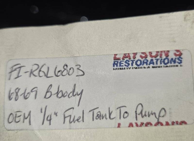

Bought a fuel tank to pump pre- bent line from Layson's restoration Ebay store because it close to my house to save on shipping. I guess I was not paying attention.
The listing was for a 68-69 OEM 1/4 fuel line from tank to pump?
From what I understand all 68-69 lines from tank were 5/16 unless A12 or Hemi ? 1/4 were return lines. but to my knowledge there were no return lines 68-69 just 1/4 vent line that I have.
Really not sure what I have ?

1/4 is a return line. Fuel separator/filter back to tank..

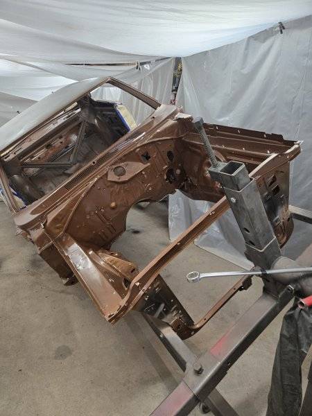

I did not see any fuel separator when I tore the car down?
383 car
See post #4. The 440 and Hemi cars had the return line with the separator in 68-69, the 383 cars did not. In the last 50 years, some 383 cars have had the return line added. Most of the GTXs I've owned in recent years had it disconnected, with no separator. Significant improvement when I returned them to the stock configuration.
