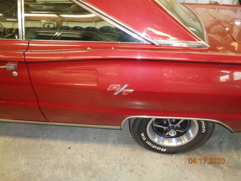

I cleaned up mine and masked them off. Then took my time, and with a razor blade, carefully trimmed the masking tape around the area to be painted. I painted them with a rattle can. Don't remember if Rustoleum, Krylon, or? brand spray paint. They came out looking good, I think..

My brother does vapor honing as he just got his new machine; when I restoed my old magnums, I did strip them down using paint remover. I used Vaseline carefully coated on the embossed spokes and center so that new paint wouldn't adhere to them when I painted them. A little over spray though wasn't a big deal, just used a razor blade to scrape it off.

Paint the whole wheel satin or semi-gloss black. It’s been over 25 years since I did some so I don’t remember which is correct. Once the paint has dried take lacquer thinner on a rag and clean the paint off of the spokes.
