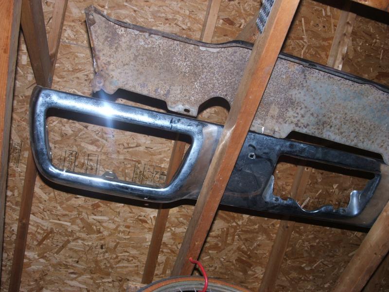

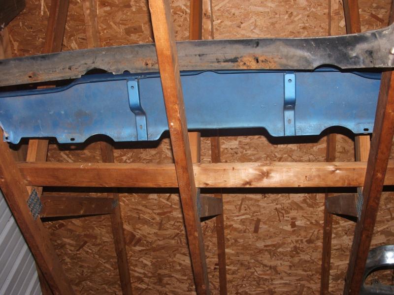

originals are very hard to find and big dollars,i had a regular valance made into a cutout valance,if you have a nice regular valance is pretty easy to do.and a lot cheaper.

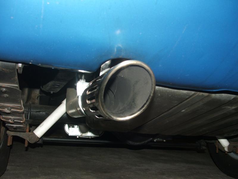

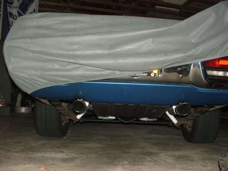

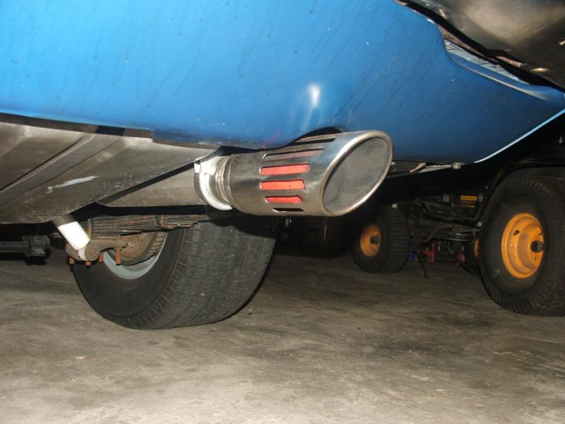

heres what it looks like i have an original cutout one but was rusty/bondo filled,used it as a pattern for the cutouts,now mounted on the car,still needs repainted,once the tips are mounted hard to tell,the none tip valance has the curves to it but are off so you have be blend them outword to make it right otherwise the tip will not be centered.
