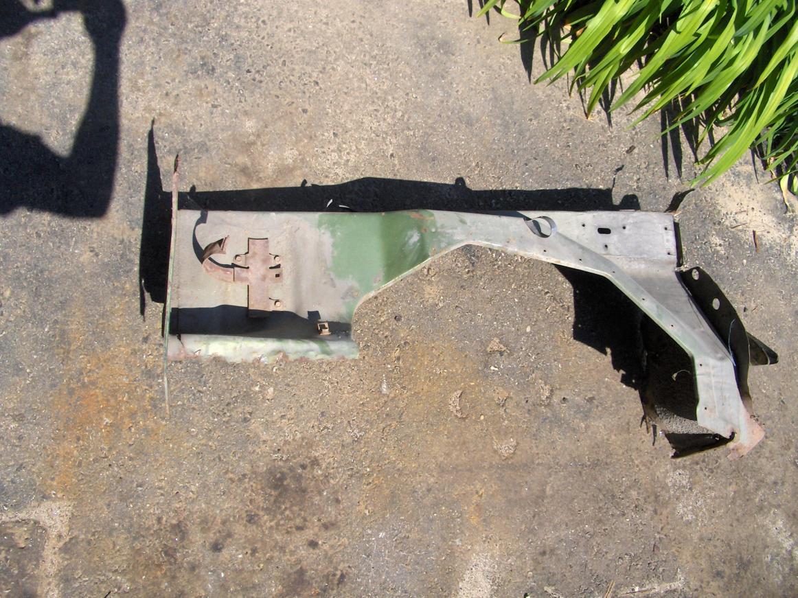

This inner fender is from a big block 400 Satellite Sebring I parted out.You can see the large opening.

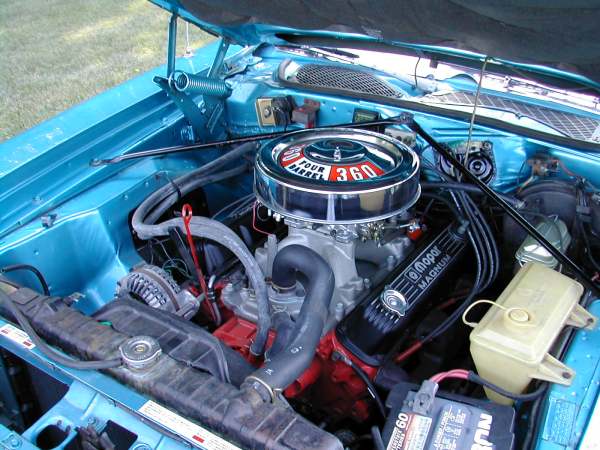

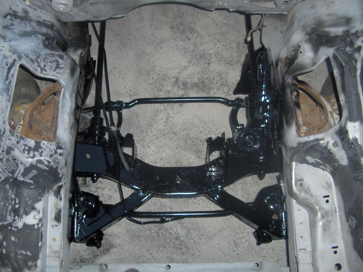

This pic shows my 1974 Plymouth Satellite factory small block 318 it only has the small opening.If you look closely you can see that the big blocks hit the passengers side inner fender when put into a small block cars.
