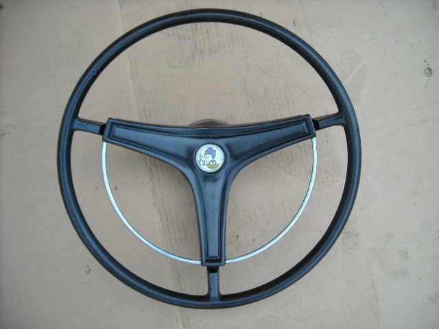

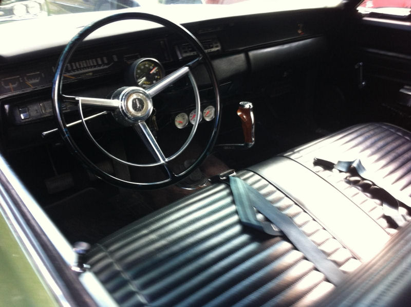

Good Day eveyone... I have a newly acquired '69 Runner clone. It was originally a Belvedere. I'm attaching 2 pics showing the current wheel configuration and the wheel that I have to install. The new wheel, does not have any hardware with it. My question is will the components from the original wheel interchange with actual Runner wheel. And if not.... where can i get the hardware to install it. I've been searching online for a bit now... and can't find any info.
Thanks in advance for any help !!!!
GL.
welcome to the site, love to see pics of your car! I would think the hardware(horn button I'm guessing) would work with the other steering wheel since they are both original Plymouth wheels.

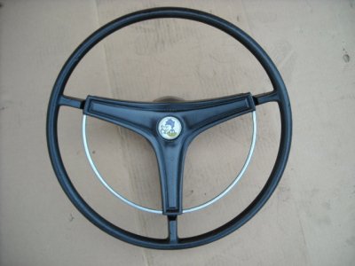

Hello, any chance youll be selling that old steering wheel? It matche my original wheel, shoot me a PM if youd like to talk about selling it.
Your horn switch itself should interchange but you are going to need the the internal adapter/mount white metal piece with steel stamped nut/plate and bolt to install the RR steering wheel pad if they are not behind that pad in the pic because the wheel on your car now does not have or use it because it is built in the chrome ring on the earlier years. I have the pieces you will need PM me
