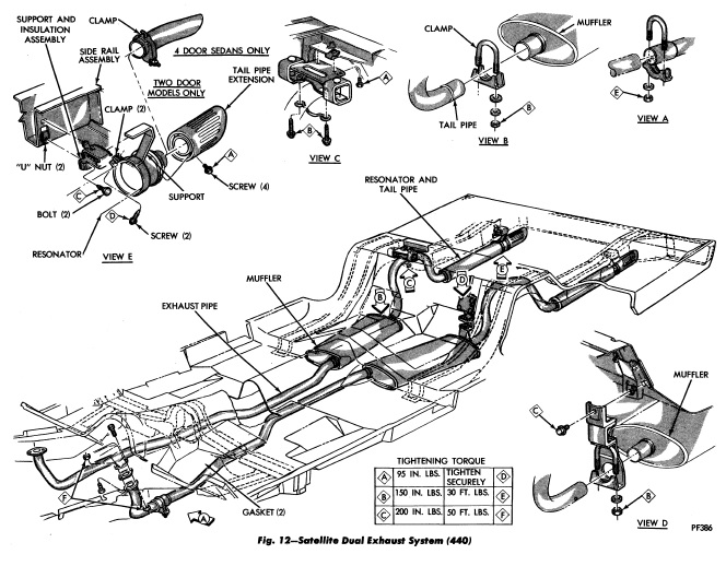

Does anybody know if 1973 roadrunner/GTX 's had H-pipes my is a real 440 U code GTX,and I'm trying to get a new exhaust made for it and everybody said 73's didn't have H-pipes.

This might help
This site never ceases to amaze me. Someone asks a simple exhaust question and a fine member sends him an entire schematic on his models exhaust system!
Wow I impressed! (And it's useful to me as well)
