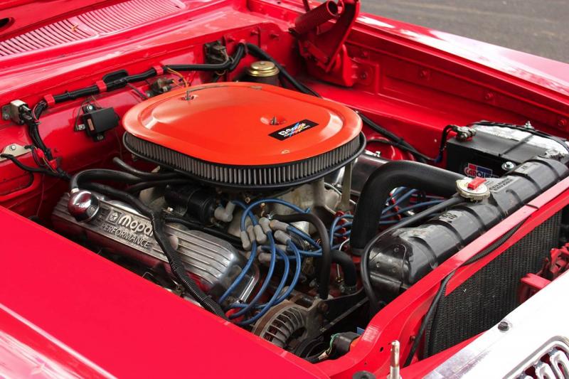

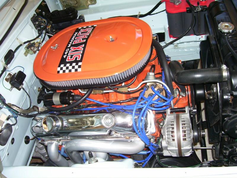

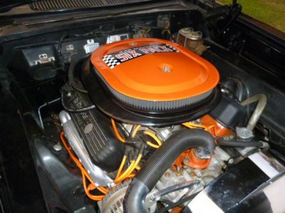

I'm assuming the difference between these two air cleaners is ones for air induction type hood the other is not? Any info is appreciated. 00M0M_cujg6Y9FgpR_600x450.jpgimage001(1).jpg
Top one is a original for a fresh air hood and bottom is some kind of aftermarket type.
fresh air has no sheild in the front, BUT I belive you can use either with a fresh air hood, the hood still closes and operates, just not correct...
i reworked the base to remove the hood sealing flange. the factory never made bases that didn't have the sealing flange.
Actually, the top pic is for either air grabber hood or non.
It is placed on with the shield in back for air grabber, or reversed for non air grabber hood. Same setup for both.

what about the breather line? can you explain this better? thanks I think I am missing something here?????
looking at them, I think the ones I have with the sheild is larger

There are actually 2 sets of mounting holes on bottom plate of air cleaner assembly that allow the screws to line up with the top cover.
Use one set for air grabber setup, use the other set for regular induction hood. I'm doing this from memory, but pretty sure I'm correct.
