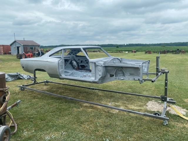

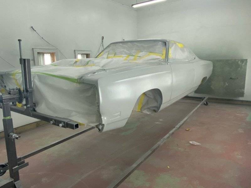

I build and sell rotisseries. I usually recommend an additional 4 feet added to the total length of the car. You need whatever distance the rotisserie pivot posts will need plus some working room at each end to be able to open the trunk and/or hood (these swing outwards a couple inches as they open). The car itself is about 16' long. I have my 69 RR mounted and its right around 20 feet. Here are some photos of mine mounted. Happy to answer any questions you might have.
