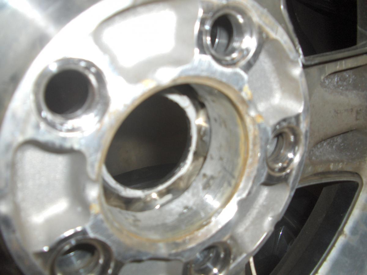

Here in the first pic you can see the plastic tabs,just remove them and the aluminum lip that the snap onto.I had a machinist look mine over so don't worry it won't effect the integrity of the wheel.

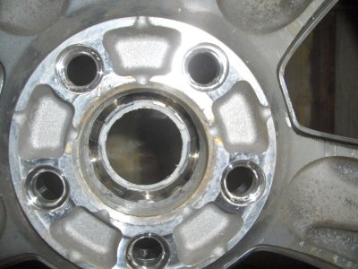

Then just clean it up inside to make it nice and round and do the same to the rotor/bearing hub.

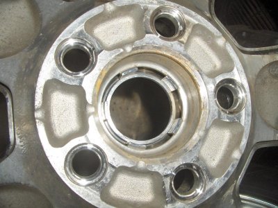

Now your wheel will fit on but your front studs will be to short because you will need to add a 3/8" wheel spacer because of the new wheels offset.
