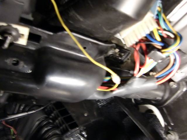

'70 charger, should the 2 steering column harness (plural) be routed under the column bracket ( as pictured ) or outside. It was originally routed under the bracket but the new ones seem to have too much volume to fit easily. I'm afraid of pinching or crushing some of the wires by forcing them into a very tight place. Thanks
They go under that bracket as pictured.
you could remove the black ignition switch harness cover of the new ign switch and will get more room, just like originally was.
