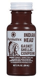

I use
... as I've been doing for 50 years. No leaks.

Ive seen this plenty of times in shops but never used it. This is applied to both sides of the gasket?
Yes. The way the old-timer in the garage told me way back...butter a nice film on the part surface, apply the gasket, butter a nice film on the gasket,wait a minute or so to get tacky, then install, tighten snugly all around, then tighten to torque.
