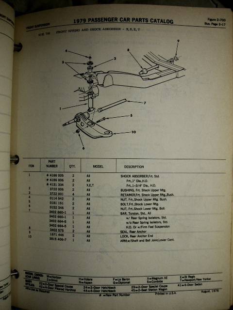

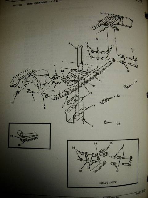

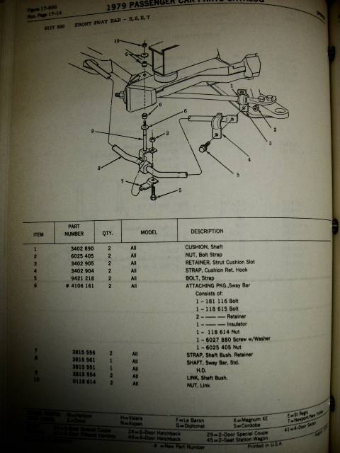

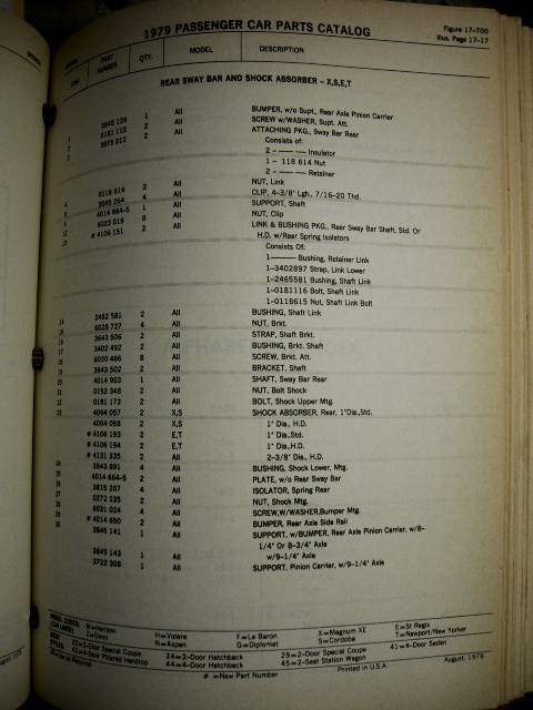

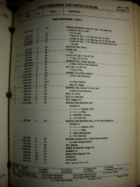

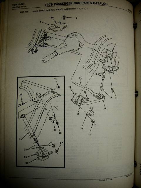

Does anyone know what the part numbers are for the rubber sub frame isolators and the rubber rear leaf spring isolators and the rubber torsion bar crossmember mounts?
Also, any idea where they might be purchased? I know there are aluminum replacements, but I don't want those.
Thanks for any information you can provide.
Hope this will help you, I found these in my Mopar dealer parts books?
Please note the index at the bottom of the page to get the correct part
numbers. Magnum=X Cordoba=S both=All

Thanks! That's about what I was looking for. Man, I gotta get me one of those parts books, they're invaluable in situations like this.
Thanks again!
