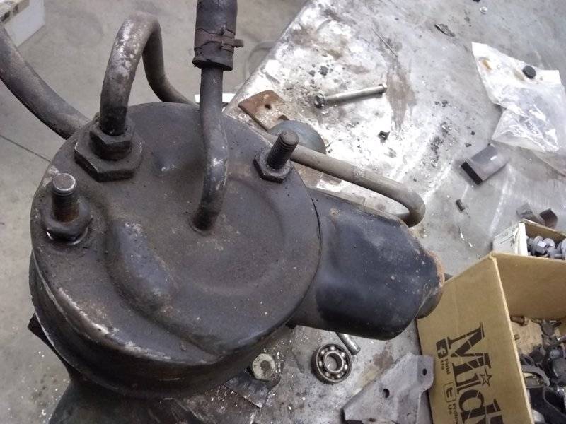

Thank God for small victories, found my old pump and it has the correct studs.
That isn't a Saginaw pump.
Looks TRW or Federal.

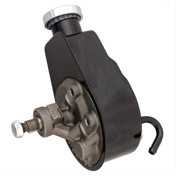

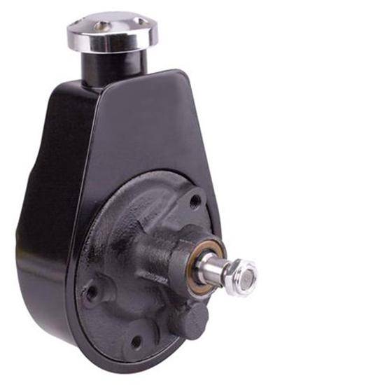

Here is a Saginaw. I wrote earlier "Canned Ham" because the reservoir looks like the case of a canned ham.
