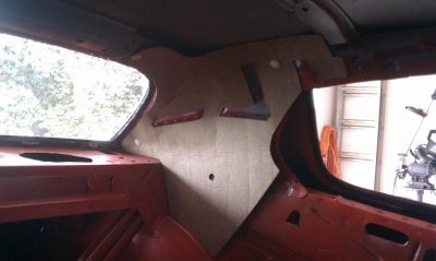

They are there to help reduce wind/ road noise. I don't know of anyone repopping. You may find usable material at Michaels or Joanne Fabrics, or use a sound deadening mat in its place.

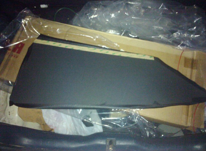

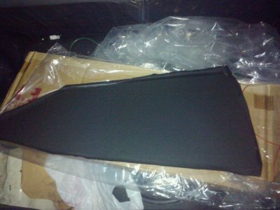

Do you have pictures of what they look like? Just curious, as I was able to get this insulation for my 73 RR, but not sure if its the same for the Charger, and mine looks like this.
Icecat, I got mine from Dante's. Fit perfectly and matched the headliner as well. I'm not sure if yours are the same style as mine as I have an SE, they may be different BUT it was the cardboard with material over.

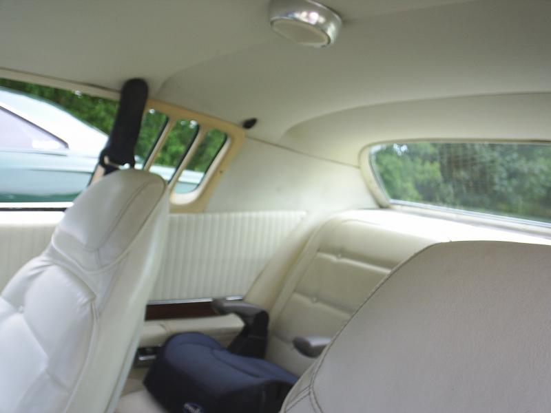

DSCN0073.html
Here is what they look like (mine are white)
All of the 73 and 74 Roadrunners I have had used the injected plastic sail panels, not the cardboard and cloth ones. And I've seen plastic ones for Chargers as well (the centers for the Chargers use a slightly different shape).

I went and pulled the tracing I made from the originals on my 74 Road Runner and those pieces on e-bay look like a really good match.

Yes, when I replaced mine, they were identical to the factory ones that literally fell apart when I took them out, but was able to verify at least for 73 they are a perfect fit. Not sure if this is what is also installed on Chargers however.
