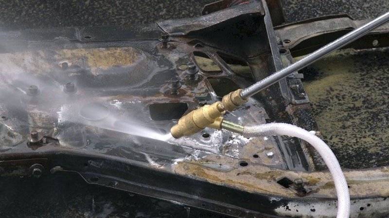

Northern tool sells a cheap kit to do it, I ended up just sandblasting using glass, stiil cleaning it of vents, etc
They have some decent ones that attach to the end of your wand and siphon the abrasive up and out.
got to say, for very little investment they work pretty good!
Good way to ruin the pump on the pressure washer. Otherwise, get er done!
The abrasive doesn't go anywhere near the pump! The whole thing mounts to the END of the nozzle. Look it up!
I’m referring to the old way, stick a hose in the media and let the pump suck it up.
Never heard of that way! Gulp!
Old school for sure. I like the nozzle attachment much better!
