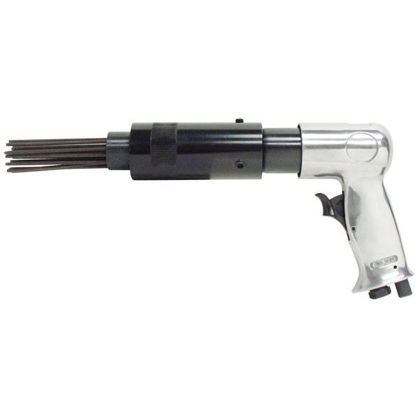

This work for me:
X2 -I agree with Prop ! ! I didn't believe it,but after spending 3 months scraping it with a putty knife, I finally bought one of these needle scalers . . . I finished the entire underside of my car from the axle back to the back ( it has the worse nooks and crannies then anyplace under the car ) and I finished it ALL in about 2-3 hours lying on my back. No hot undercoating dripping on me and burning me . . .
The tool is incredible - and it's very easy to use too. You can pick it up at HF for $30 - use their 20% off coupons and it's even cheaper. Go to youtube and search for it and watch the video of how easy it it to use . . . you're wasting your time with a putty knife and torch . . .

I used the needle scaler on the outside of the inner fenders, and yes it worked great. It is time consuming though so that is why I asked about sandblasting the underside. I will continue to use the needle scaler, thanks to those who responded with helpful suggestions.
You are getting good advice here, the needle scaler is the way to go! My blaster accomplished almost nothing on the undercoating of my 66. Needle scaler makes quick work of it then you can clean it up with the home blaster.
