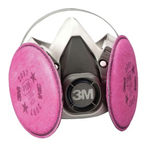

i hope you wear a good respirator and are working in a well vented area PLAY SAND has SILICA .
for $8.00 #50 bag of black diamond blasting media a tractor supplly works really good keep sifting it after use it will last for a few blastings and is silica free .

I wear a pink HEPA respirator and not just a paper dust mask
I do it outside too.
