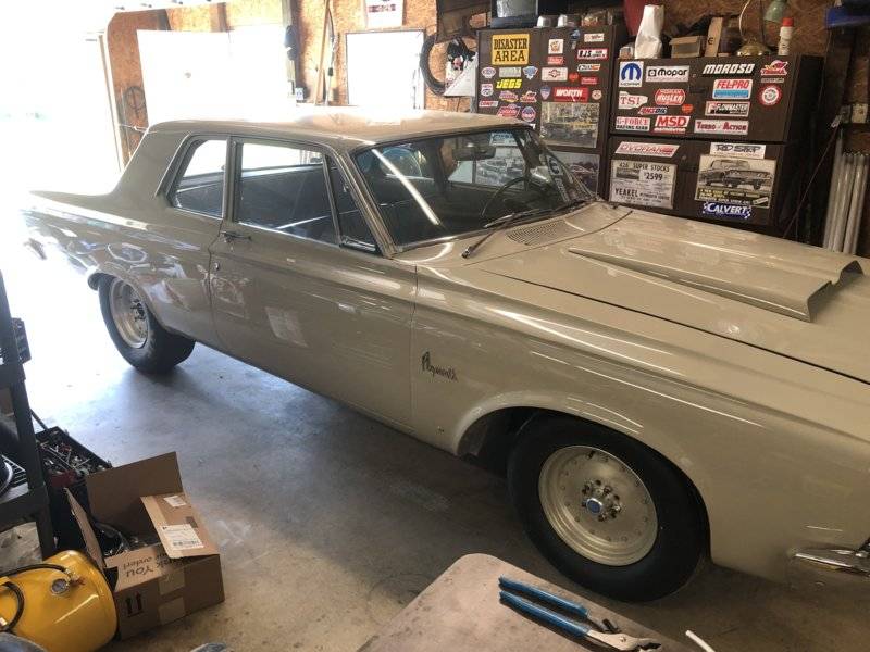

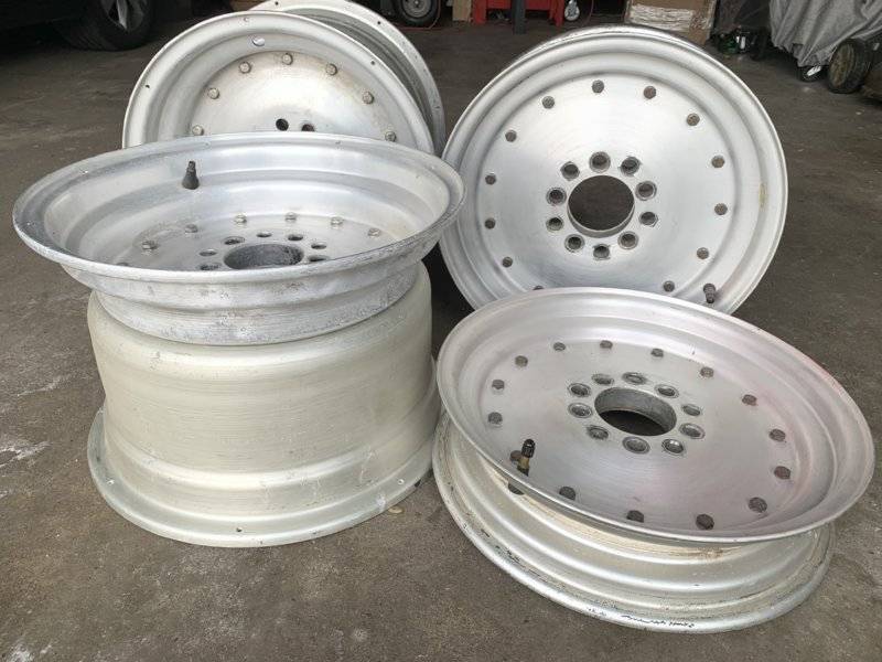

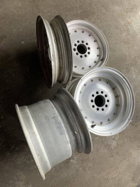

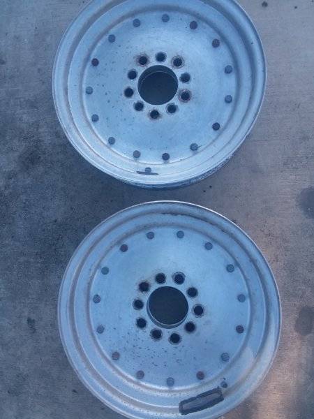

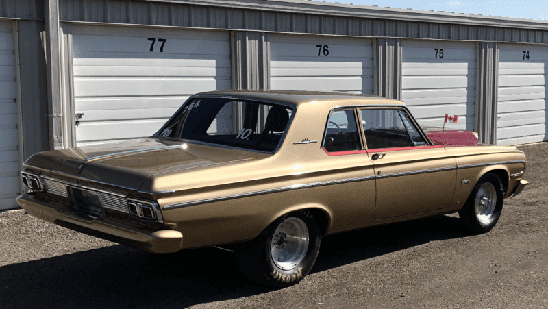

These are kinda beat like my car. Rears are 15x10 with 6” bs, fronts 15x3.5. Ordered Hoosier 29x12 slicks. 13.7 cross section. About 2 inches wider than the MT 295/65 r15s on 15x10 5.5 bs seen in this picture. I’ve got little over 16 inches of clearance.

Ive got a pair of 15x3 1/2s too, but i wish mine were as nice as yours! Mine were neglected, sat outside in the weather for years. If you decide to do a restoration on yours, please post up a thread! (Mine need it, but i would leave yours just as they are!)
Edit: did you get the caps with them?

no caps. I’ll be leaving them as is for now. They fit the car’s theme better. I had planned to check on the Bogart versions. But haven’t seen or heard about them being used.

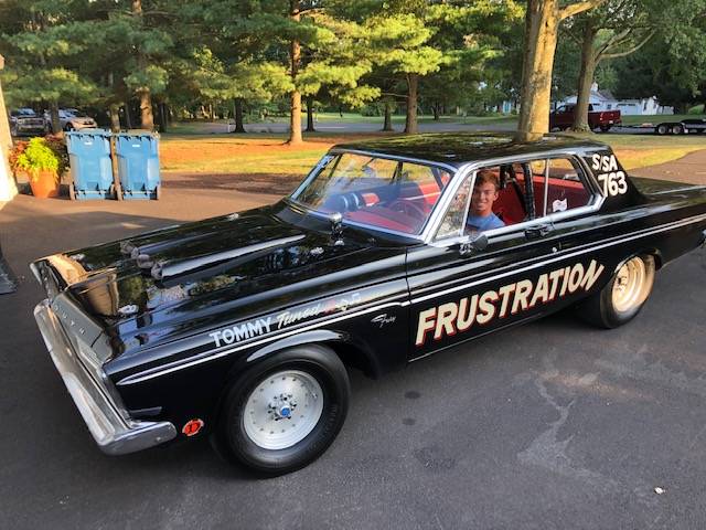

My 64 will be coming home
From storage next week, with Super Tricks on and ready for the next outing, whenever that happens.
