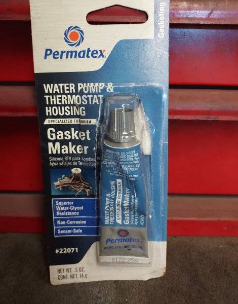

I used this last time and so far so good. Follow the instructions.

That's what I had a problem with on a t-stat housing. Kind of squeezed out. What I posted hardens a little better and is staying put. I like Ultra Black for other gaskets and if you're in a hurry Right Stuff is very good. No curing time before final torque like Ultra Black.

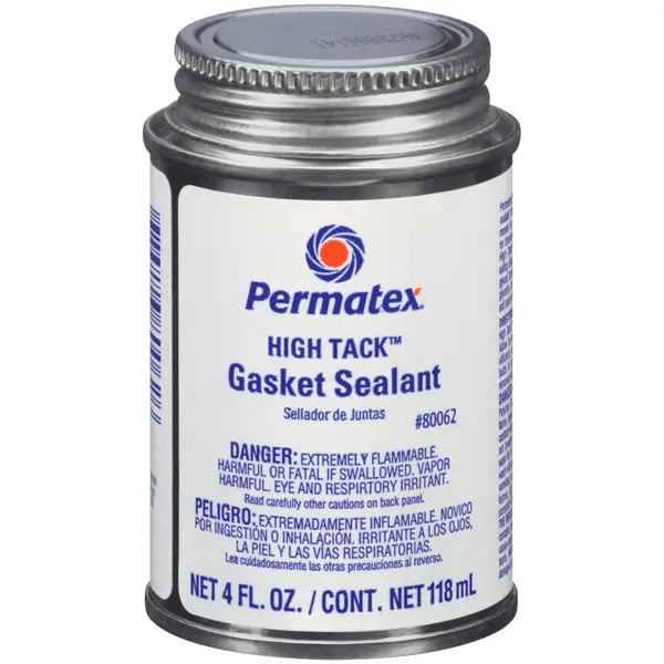

Ok.....i've used Permatex High Tac brush on sealant.....works well.....just something to consider.....
