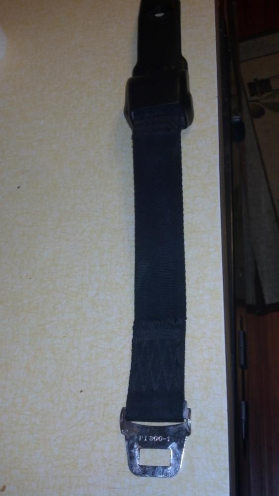

I purchased a complete set of used green in color seat belts that were removed from a 1969 Dodge Charger.
I would like to dye these black in color. Has anyone done this? Do you have any resource(s) as to where I can purchase the dye?
Thanks!
I boiled a large pot of water and put in rits liquid dye and a powder few packets. They came out great. I then painted the latches and plastic covers with Herbs Mopar restoration spray paint. The look brand new and the paint is durable.
