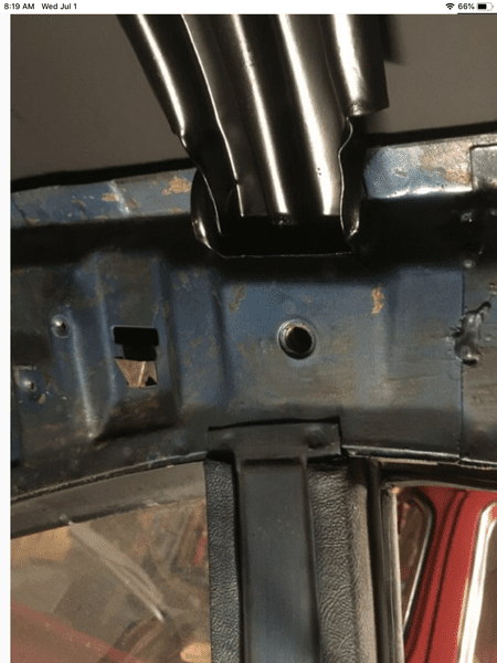

and where are the upper points? a location in reference to quarter glass would help
Hope this helps....Jim
