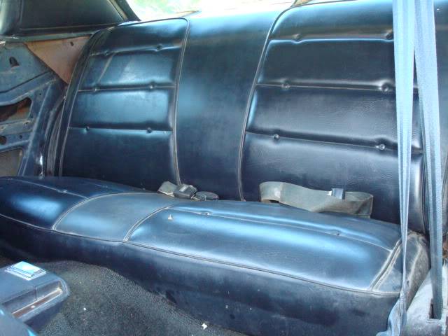

Lap belts in the rear.

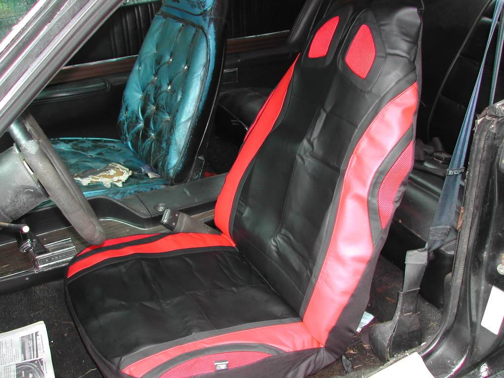

For fronts,
there is a retractor for the lap portion behind the front seat.

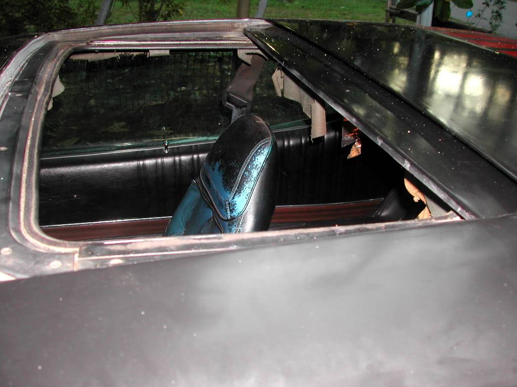

from this, the shoulder part goes to a hanger slot from the roof,
which goes to it's own retractor under the rear interior panel.
shown with rear panel off
