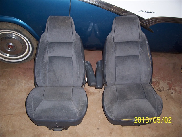

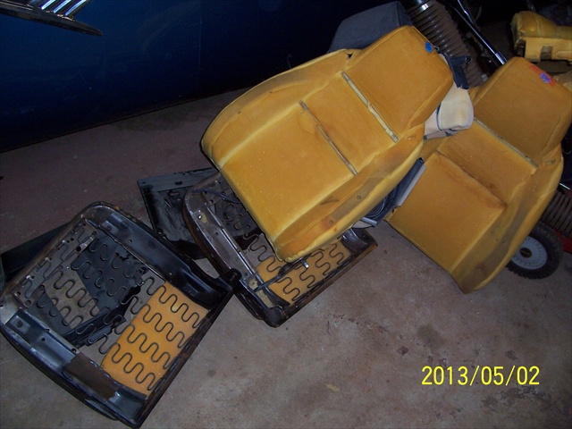

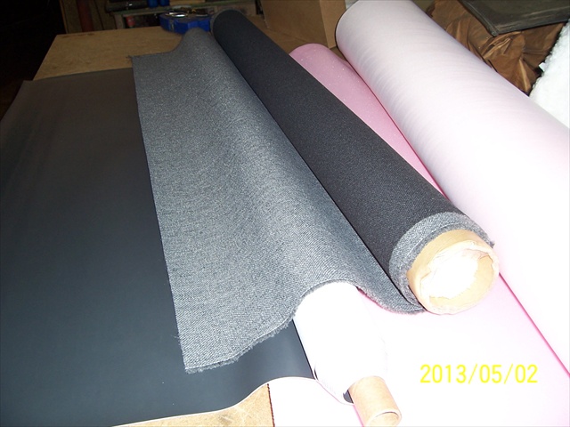

I intend to reupholster these and repair the foam so they will be nice. I will be using these two fabrics and new sew foam.100_7272.JPG100_7271.JPG

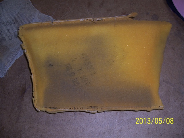

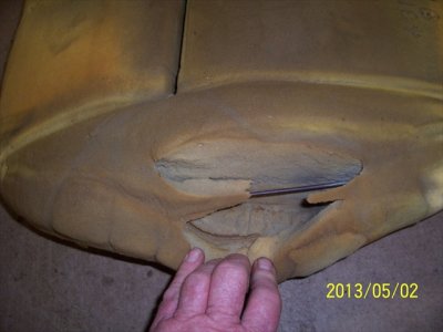

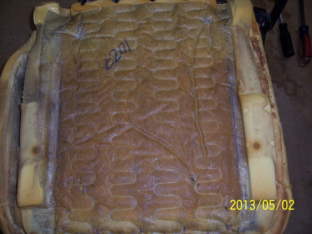

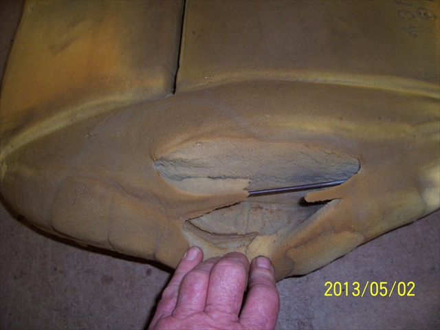

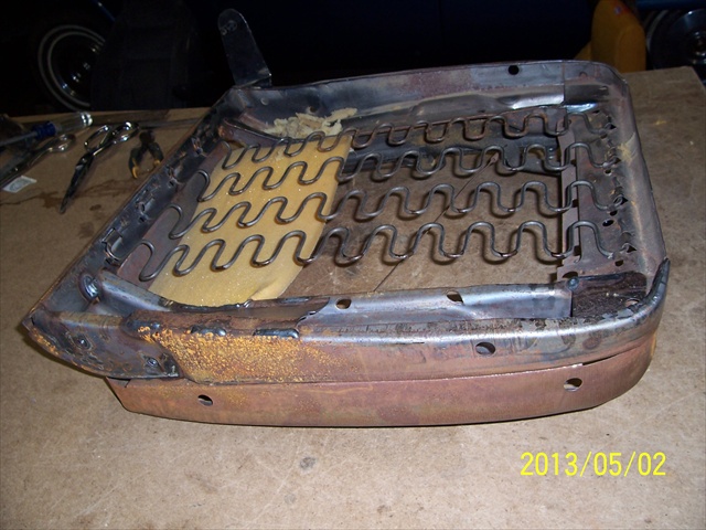

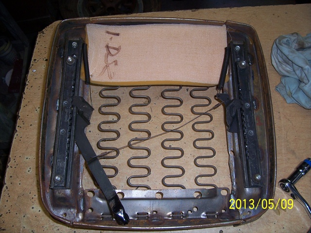

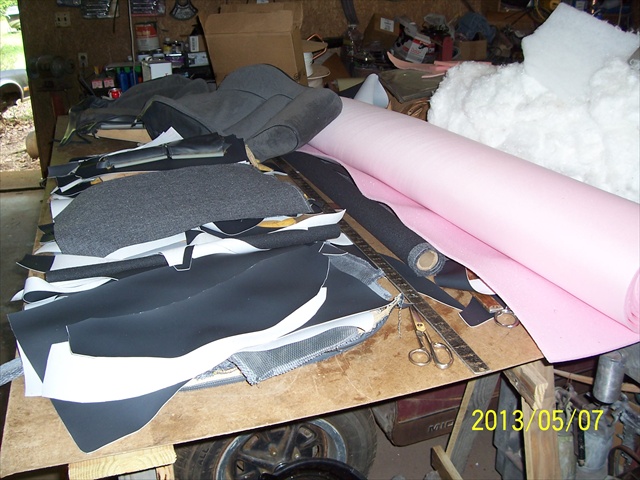

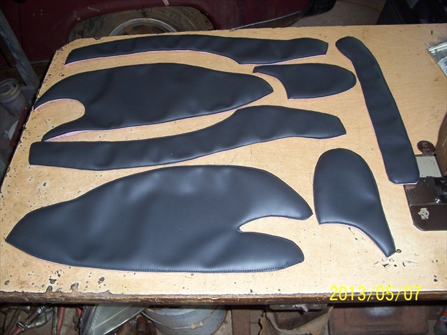

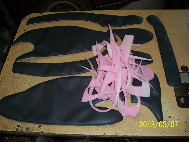

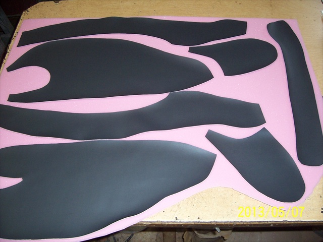

All the pieces cut out. Sometimes I pattern this stuff, other times I tailor it. These seats are a little bit of both.

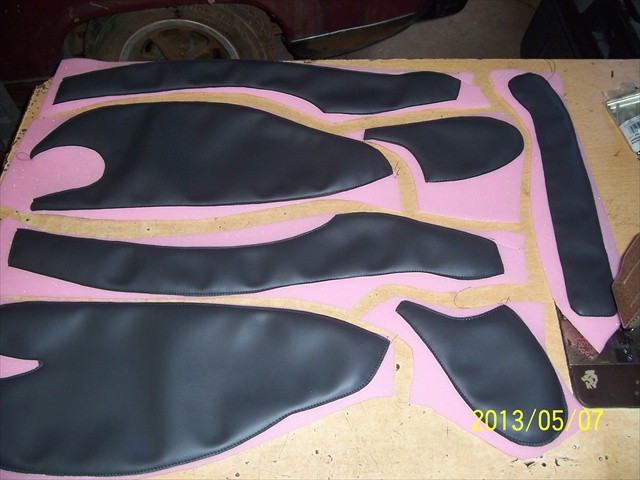

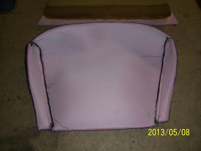

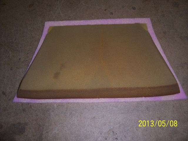

We lay all the pieces out on 1/4 sew foam.

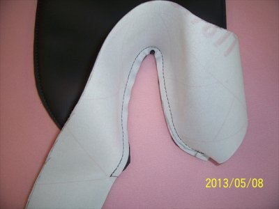

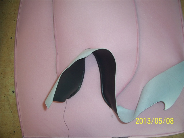

Now we sew all around the outside edge of these parts. Sometimes we glue the fabric to the foam, but not on these as I want the fabric to move independent of the foam.
Next we trim off the excess foam.
Now they are ready to be assembled.

Here is a pair of bucket seats out of a 1992 Dodge Ram.View attachment 120745

This foam is already reinforced and in pretty good shape.View attachment 120759

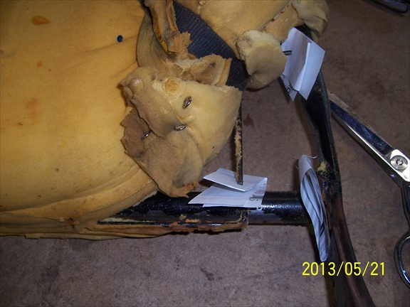

We will need to repair this cushion foam as you can see.View attachment 120760

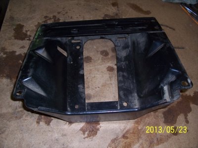

These seat frames are very sturdy.View attachment 120762
Now they are all dismantled.View attachment 120763

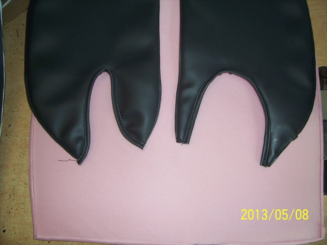

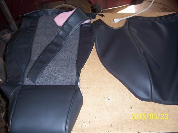

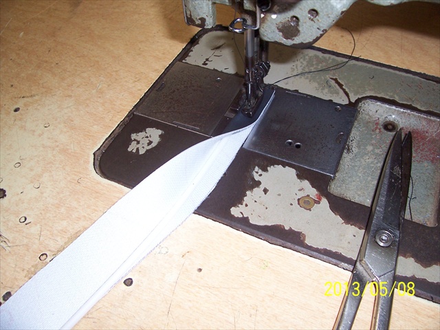

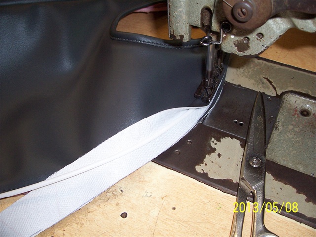

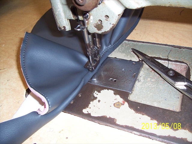

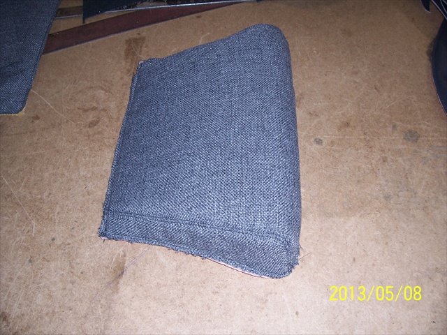

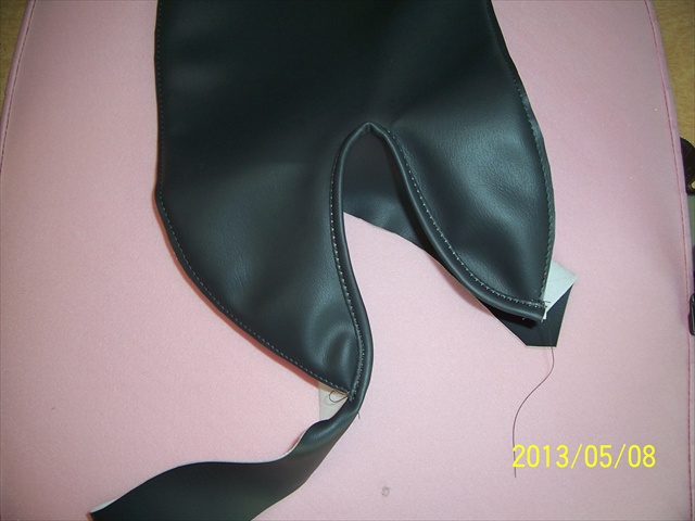

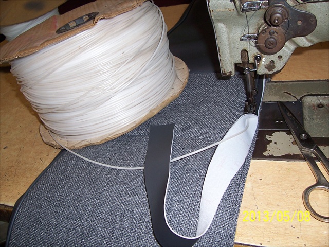

I like to take care of all the rough edges I can before actually sewing up the covers. So we take a piece of scrap fabric with a strait edge and sew it to the part.
Then fold it under and sew it again.
Done sewing.
The back side.
Trim off the excess.
Finished parts.

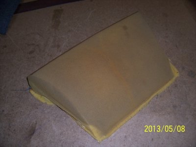

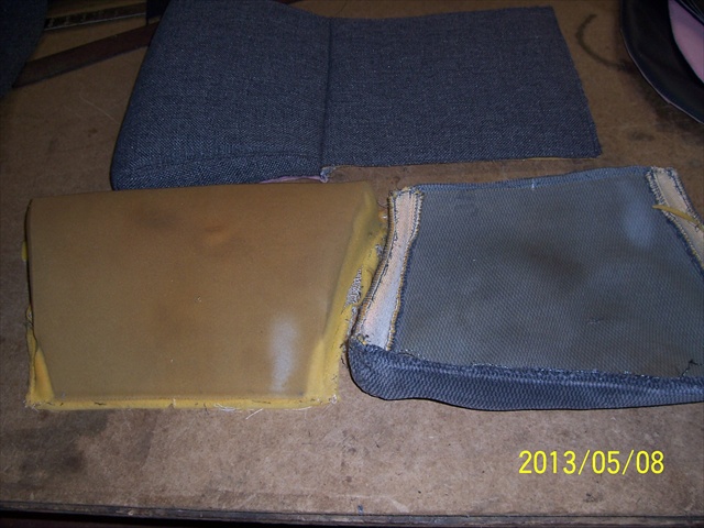

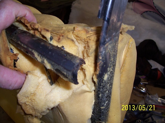

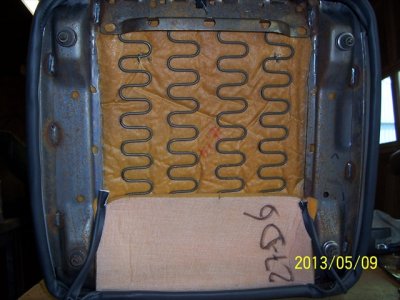

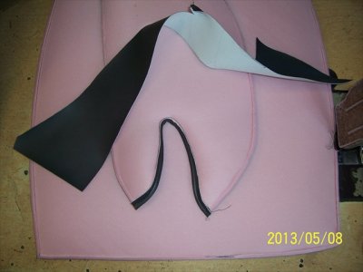

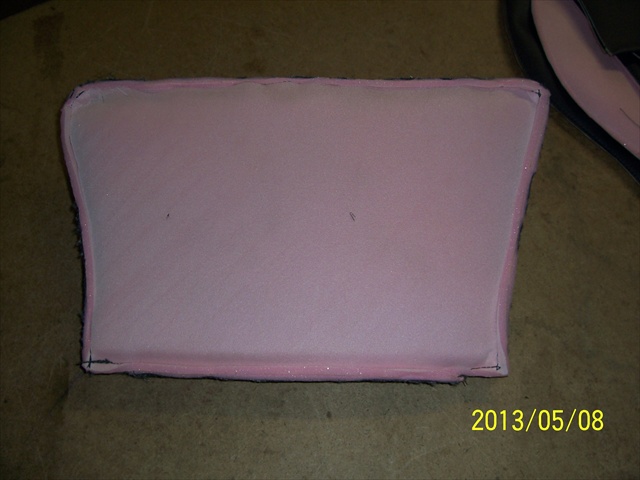

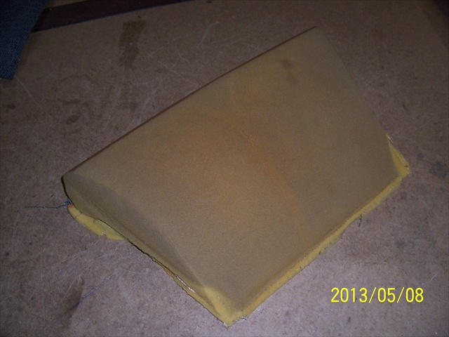

I elected to reuse the knee bolster foam but I will have to repair them a bit first.

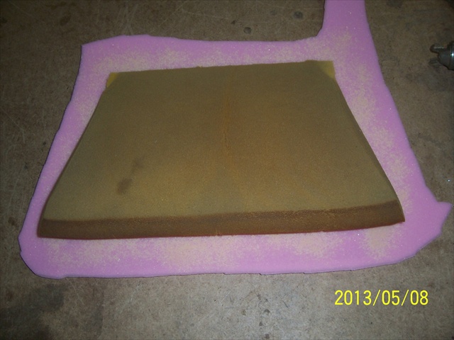

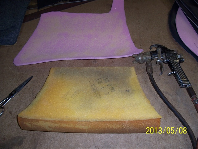

I removed the backing and cut off the outside edges.
Then glue a new piece of foam to the old one and trim the edge to about 1/2 inch larger than the old piece.
Then sew the new cover to the bolster.

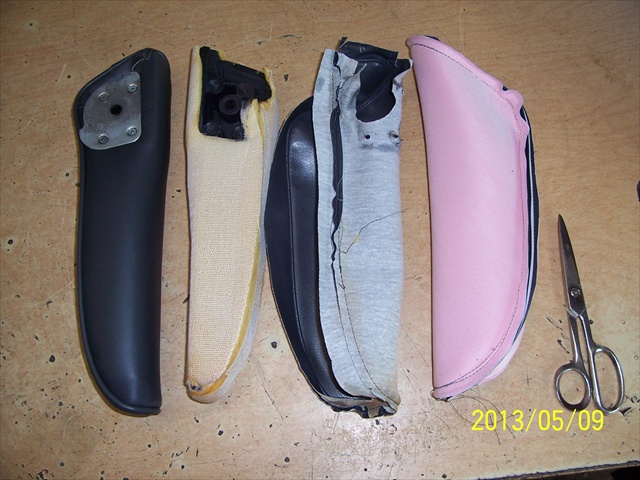

You can see my cover has foam sewn to it as the original one does not.
The arm rests from left to right. The new done one, cover removed, original cover, and mine also sewn to foam and the original one is not.

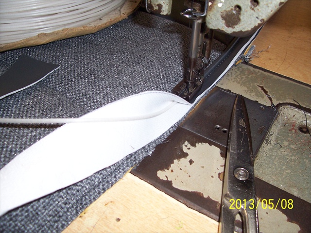

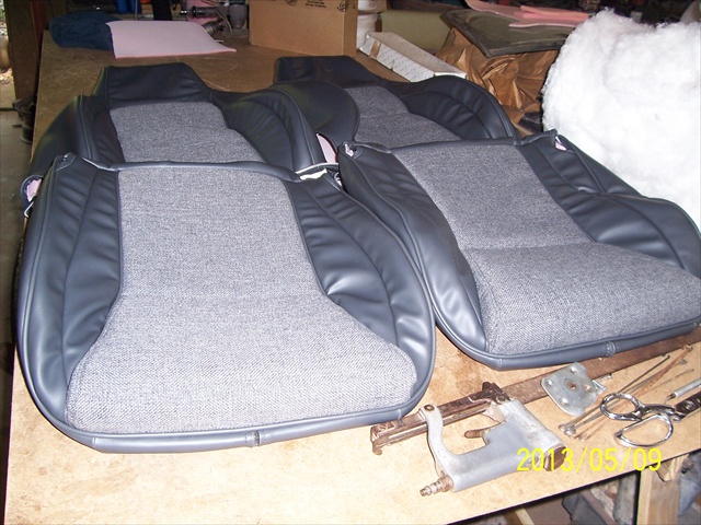

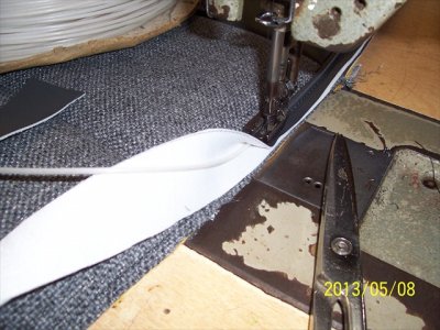

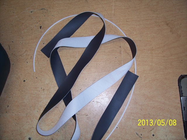

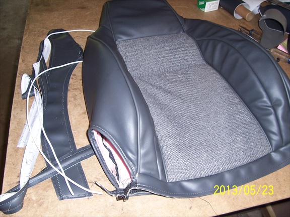

Now time to sew it all up. Start with the welt cord. Small diameter for the inserts and large diameter for the rest.

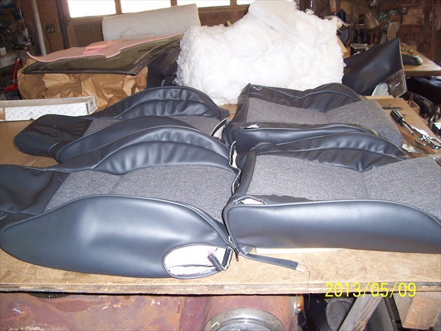

All the covers are together.
Ready to be installed.

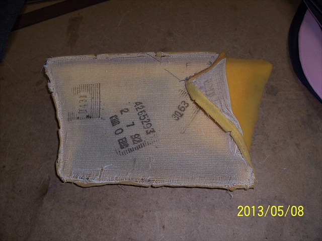

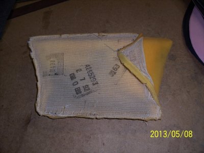

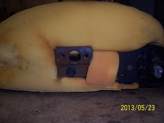

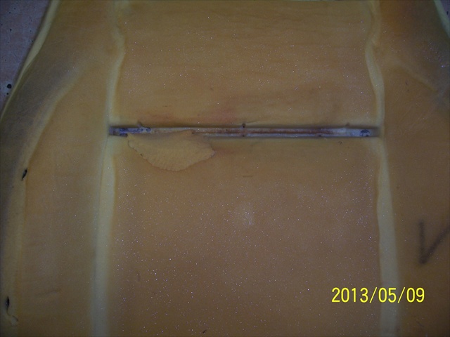

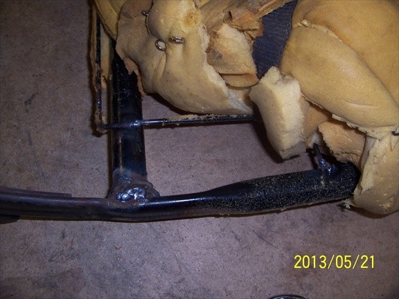

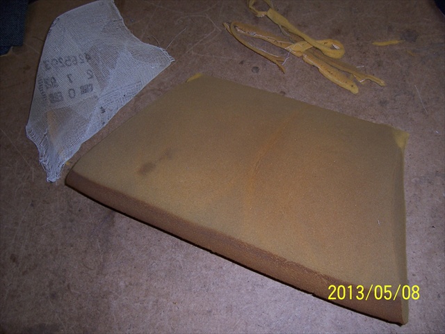

100_7327.JPG-5.jpgNow i have already installed the cushion cover after I had repaired the foam, but as I am not accustom to taking pictures of my work I forgot to take pictures of that. So to show how to repair the foam I will use this photo of the factory repair. In this photo you can see where they glued a piece of foam into the bad area and then trimmed it into the shape to fit their needs. I did the same thing to the cushion.

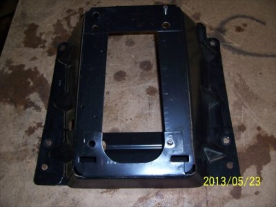

These photos show the bottom without and with the seat tracks. As you can see these would be very easy to install in some other vehicles

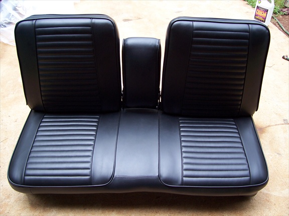

$45.00 Later. I cut out the defective parts and replaced them.

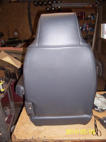

A view of the back.
Another back view,

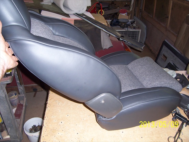

The seat in the forward position.
Reclined.

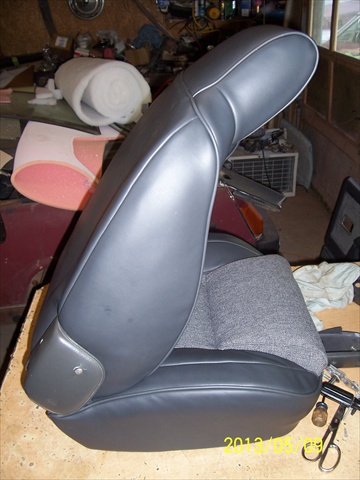

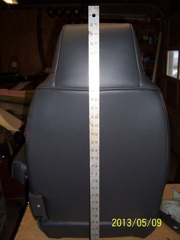

I had not imagined how fast this seat was going to recoil after I pulled the release handle. It sprung forward and smacked into the head of my sewing machine. It scuffed the welt cord and a panel. I will have to cut this back apart and order more fabric and replace those parts.SHHHHH.

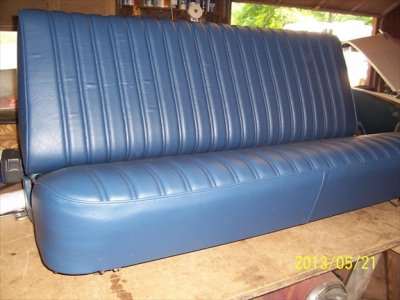

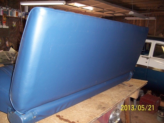

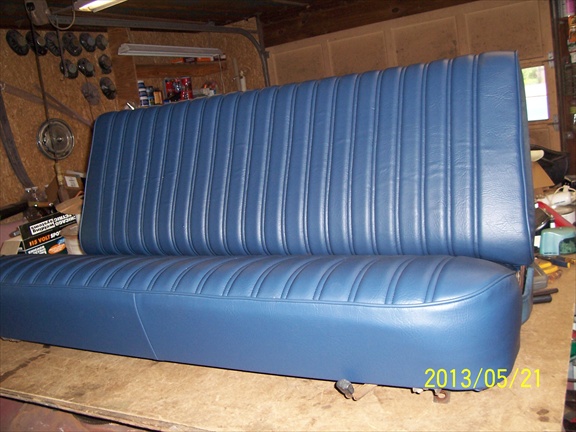

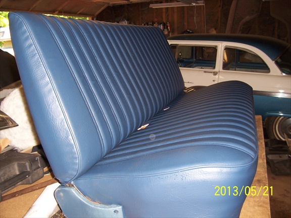

So while I am waiting on the fabric to arrive I knocked out this chevy truck seat.

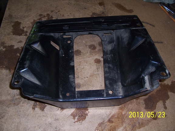

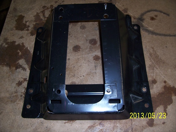

I don't know how all my photos got jumbled around. The seat risers for the buckets.

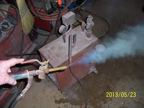

This is my steamer.

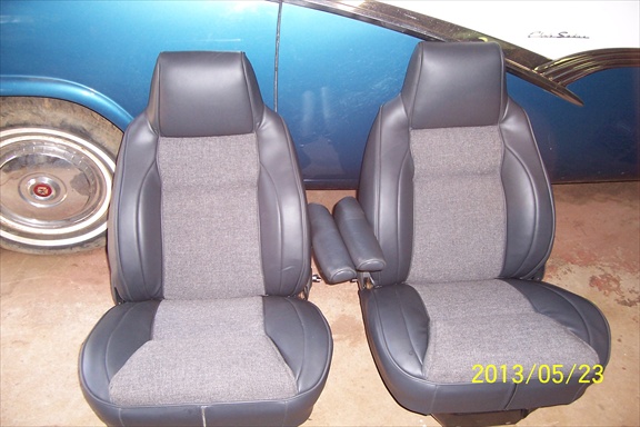

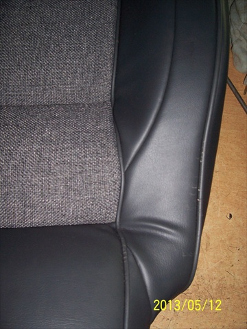

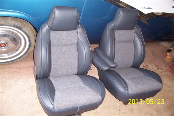

And finally the finished seats.

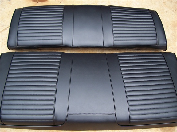

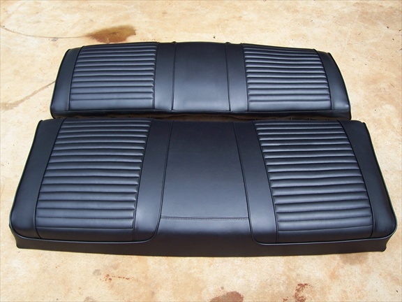

I can picture in my mind these seats being done in a bunch of different ways.Here are a few photos of some Dart seats I did a while back.100_0214.JPG-5.jpg
I sewed all these covers and I have come to the conclusion that I can do seats much faster than I can do the picture lay out. I must admit that I came real close to introducing this computer to my .45. (LOL) I hope y'all enjoy this and it gives you some idea of why the cost is high. Later....Bill

It would be very hard to price any upholstery work without seeing the actual job that needs to be done. Just to give you some idea of what my charges are, these two bucket seats and two door panel inserts (you can see one of the door panels in the photo of the seat in the reclined position) cost $750.00. You also have to realize I supplied all the materials and necessary commodities to do these. The blue bench truck seat was $400.00 and I also supplied all necessary items to complete this job as well. I always tell everyone to check in their own local area for prices (at a quality trim shop) and compare them to mine. I am a retired professional trimmer and it will be very tuff to beat the quality of my work. For those of you that do not know me my real name is Bill Holbrook and over the years I have received many awards in many magazines and at many shows. Now that I am retired I still enjoy doing this type of work as it allows me to use some of my creative skills. So I am always interested in custom work as well as installing your store bought covers. For high quality reproduction covers I highly recommend Legendary for anything else I recommend me. lol.
