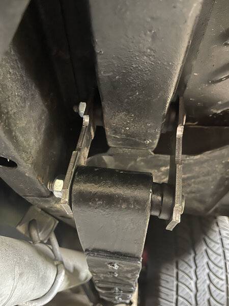

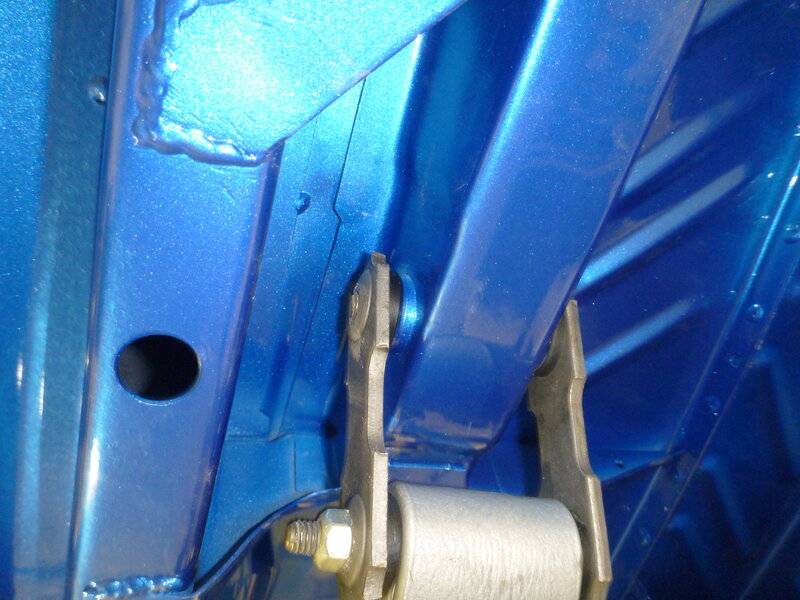

Ok, replaced bushings got everything together and tightened down. Now the passenger side looks like is bowed to the inside. Front bracket and leaf bolt all lined up good. Old hanger was fine and looked pretty straight when I put the new hanger in. The picture is after all is tightened down.

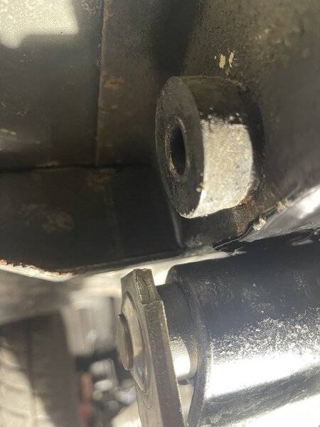

You smashed the inner bushing into the spring, not allowing the outer bushing to completely go in.
Yep, unfortunately you need to take that one back apart.
What would make the spring push to the inside though?
That’s the ones espo sent me for the application. I took it back apart and tried it sprung and unsprung and beat the tar out of the spring with a deadblow to the outside. I got it looking a lot better but the still is a cant to the shackle and the spring isn’t centered to the frame(see the last picture I posted).
