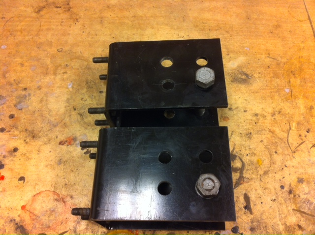

Hi, try to drill new holes in the front hanger, I have done that on mine but I am not sure it will be enough material on stock hangers.
It is a set of superstock hangers that I drilled two more holes in.
This will probably lower the car 30-35 mm.

Beware of lowering blocks. They can, and will, block the access to the brake adjustors making adjusting the rear brakes ......ummmmm....interesting. While you can remove the front hangers, flip them over and swap them side to side after elongating a few holes, you may find that lowers the car far too much at the rear bumper and raises hell with pinion angle. Solution? You can use the front hangers that Swede suggested and drill your own hanger holes if you are using stock front segment springs or get some correctly sized "C" channel steel material and build your own. You need material that is 4 1/4" long by 3 1/2" by 3 1/2" by 3/16" (adjust for metric if needed), knock the studs out of a set of stockers for a pattern and drill stud holes in your hanger material. Drill the hole for the spring eye slightly higher than the stock hole would be. Caution is advised here. Raising the hole an inch will result in over 2" at the rear bumper. You might make a couple of sets to get it right. Good luck!

You hit the nail on the head. Messing with the front hanges reaks havok on the pinion angle. You may end up putting spring pertch shims in to correct that. Another option would be to call pst and get a set of there performance drop springs. Once youve done all this. Youll probably want to invest in a ser of good sway bars. Just my 2cents i wouldnt skimp on this. i would prefer drop springs over butchering the front spring hangers.

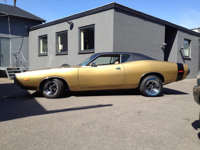

reasons for lowering is related to larger wheels on the back, there to much sag in the old leafsprings, I bought new springs, these are fine but just a bit too high - that's why :)
Others on here will tell you to expect some settling in those new springs. If your car photo is current, I think it has a great stance.
Here is updated photo

nice car,,,,id leave it just like that....looks good ! if you're trying to level it out,,,,,crank up the torsion bars a bit.....thats a hell of alot easier than going thru all that mess with the springs!
That is indeed pretty high out back!
A drop block would be the cheapest answer here.
Also any spring shop should be able to take out a bit of the arch in ur springs if you are willing to take them out.
X2 leave it alone and drive it.
