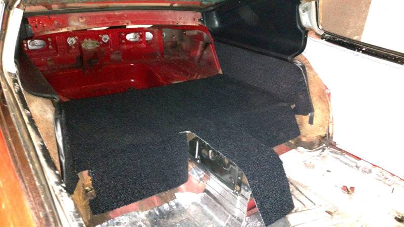

I bought mine from www.stockinteriors.com
They sell ACC carpet and it fit fairly well with the exception of a small place near the back seat but we were able to make it work
BTW The mass backing is worth it but it did make it a little harder to install

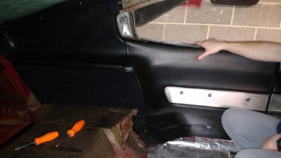

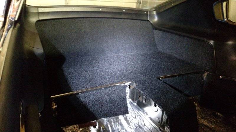

In the back of your car --- did you put the carpeted side panels in first before putting the interior carpeted floor pan in?
Yes,
The sail panels go in first
Don't forget the cardboard sheet that goes under the carpet or the "wells" in the floor pan will be visible
I also used sound deadener on and under the floor pan
