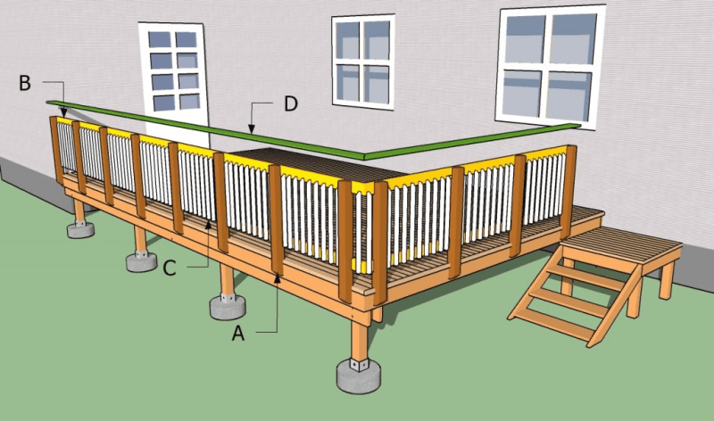

^^^This. Now you’re in a hard spot. Posts should be resting on footers, not in the ground. The footers would have been poured first and would be clearly visible. Anything else would not be correct. Since you already paid the contractor at this point you don’t have much of a choice other than to let him finish what you paid him for because I seriously doubt he is going to give you back your money. I would watch him like a hawk from here on out and make him do things correctly. Be a royal pain in his *** and if he gets upset tell him he can’t be trusted so it’s either this or give me money back for what you didn’t finish and take a walk.
Pour concrete footing in sono tube and embed a post saddle in it. Then bolt posts to saddles. No premature post rot.

Years ago we did things a bit different, but today in this part of the country, the post can't come in contact with the dirt at all. A fence post is different. Hope you get it squared out.
