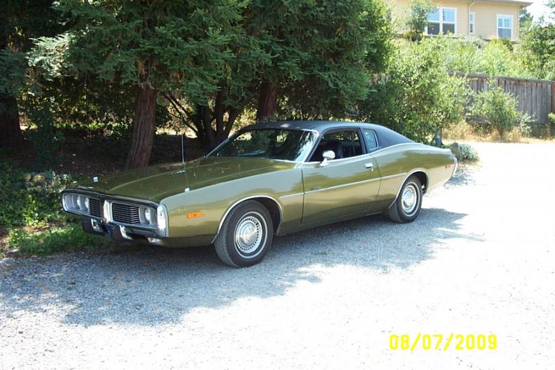

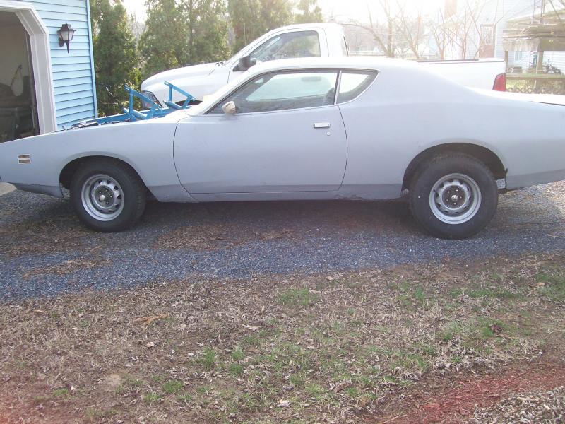

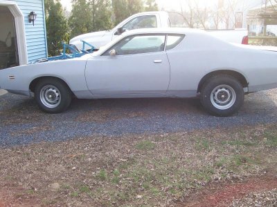

Getting closer to buying new wheels for my '74. Probably going with Magnums, although steelies painted the body color with silver center caps is very tempting. I've got more a mellow cruiser than a muscle screamer, so I want wheels that look good and improve the ride/handling over my stock 14's. Before you say "why replace the stock wheels?" it's because almost nobody makes the stock tire size anymore, and the Green Monster's tires squeal even in normal speed turns.
Talked to my local tire guy, he suggested 15 x 7's with 215 65 15's on all four. Does this sound right, or should I go 15 x 8's? As far as tires, Radial T/A's seem to be the standard, and the lettering looks good.
Any feedback on wheels, tires, where to buy them would be appreciated. Thanks a bunch!

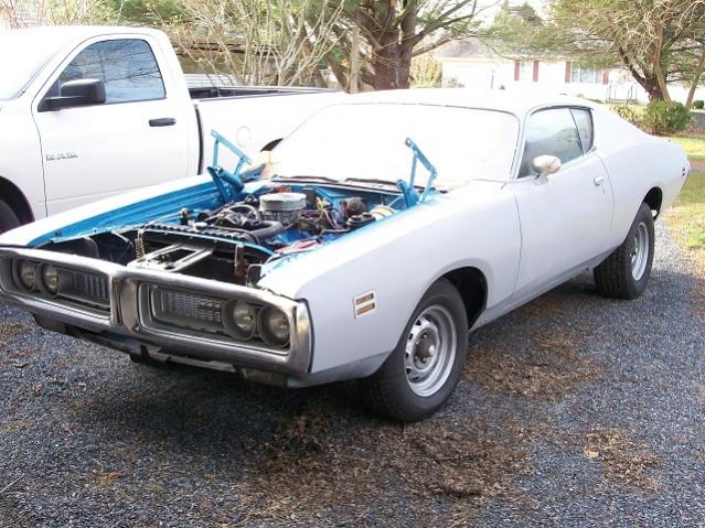

Here's the Monster with the stock rims...

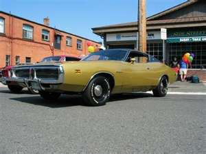

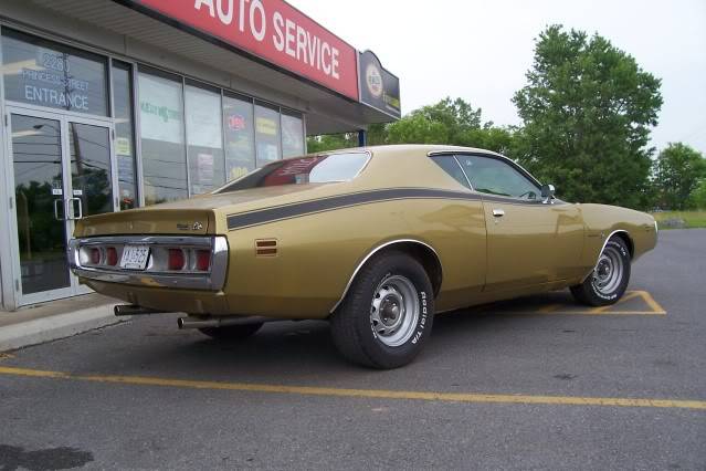

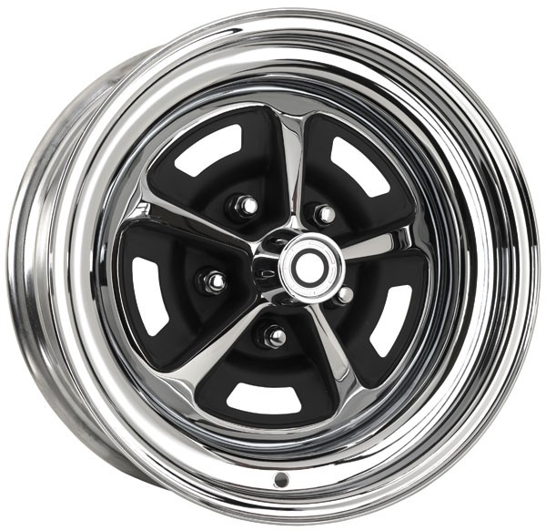

I like all three but my budget requires low cost so steeleys are my choice for wheels on our [my sons] charger but my son has other ideas.

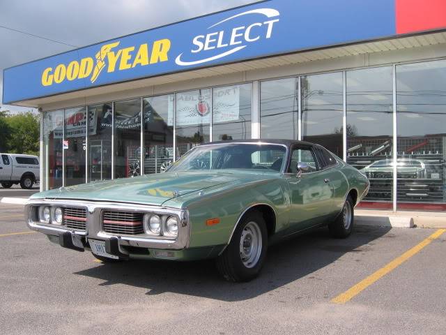

B bodies look so good with ralley wheels and and that bad boy is just beggin for a set. I'm gettin ready to put a set on my Cordoba too.
Fla, those steeleys are sweet. What brand, size are they? If I go that route, I'd get the rim painted the body color and leave the center cap silver.

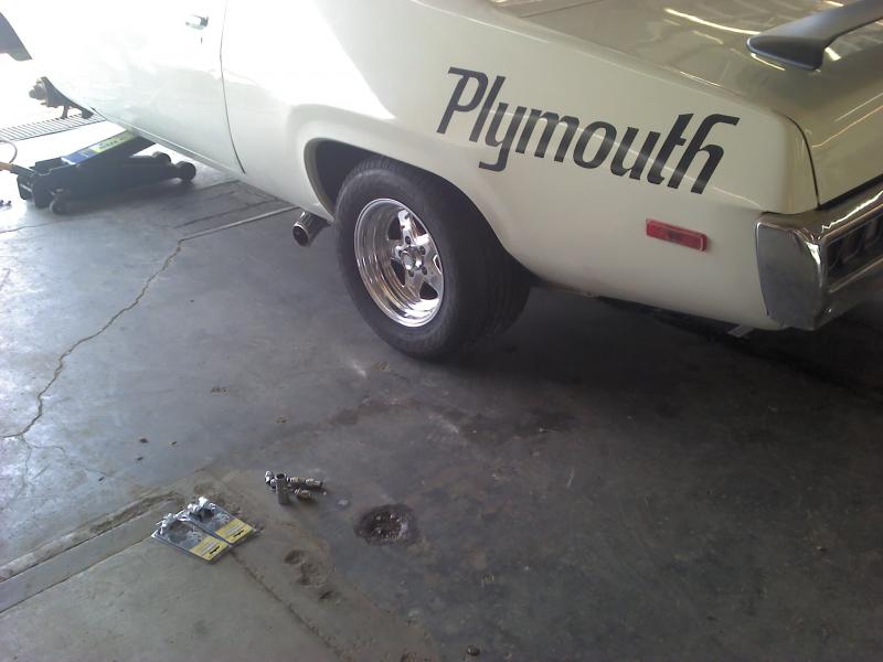

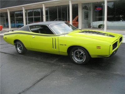

Here are two examples from my shop.
The 71 Bee has the fatties in the back,and the green SE has the 2257015 all around.
hope this helps

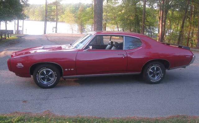

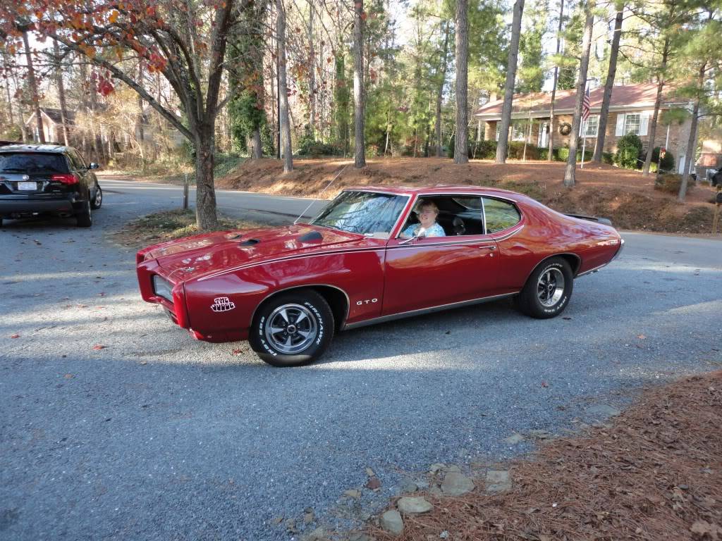

Price was on object on my 69 GTO.
Saved a pair of 15x7 Rallys from the junkyard but kept 14x6 up front.
225/70/14s, 275/60/15s
big bumps and a full car can bottom the rear on these.
the offset is a little too much. it hurst handling in a coil spring rear worse than a leaf spring rear in my opinion.
would go to 215 or 225/70/15s if had the extra cash and another pair of 15s

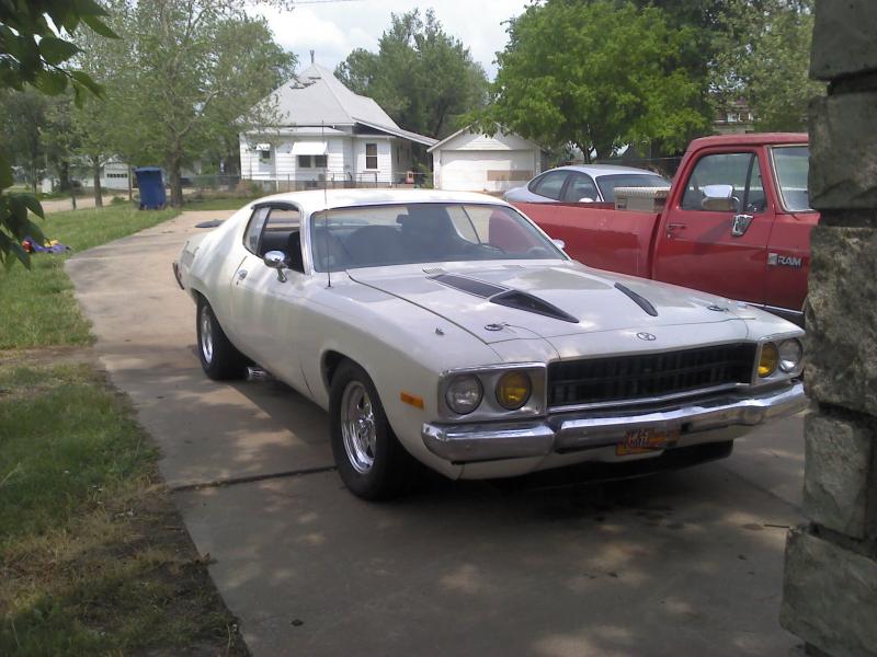

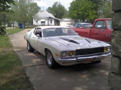

Mom, who brought me home from the hospital in a 68 442 and took me to my first day of school in a 69 Daytona is getting some time behind the wheel.

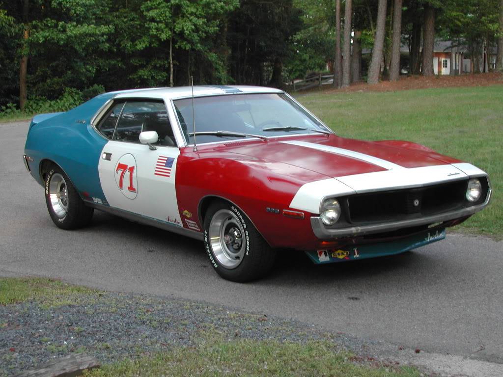

on a 71 Javelin that originally had all 14x6 rallys I rescued four 15x7s and went with 215/65/15s and 255/60/15s. the offset is better. it is slightly less than the GTO and in a unibody, leafspring car handles great.

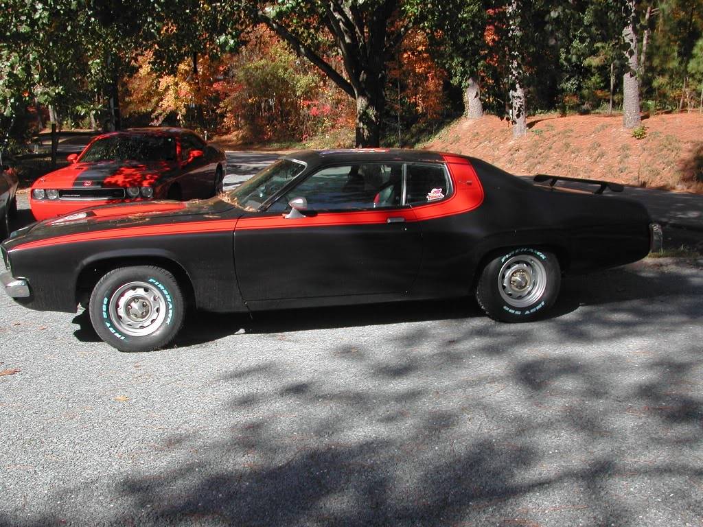

Now, closer to what you are looking at. is my 74 RR.
I got some 15x8 rear Wheel Vintiques. I could not find any inexpensive 15x7 Rallys locally. (not happy as one would not hold air new, had send back. And their powder coat must be painted over, they make them at a fair price and not a lot of other repro Rally options in this size).
again 275/15/60s on the rear. did not buy 15s for the front, painted some 14x6 and went 225/70/14 again.
no problem with that size on the rear. I THINK you could go a touch bigger there. I THINK you could go a touch bigger on the front.
If you do not want to offset and they fit, 225/70/15 might be a good choice all around. For performance, no offset, sticking with 15 inch RWL it would be awesome if 245 or 255 60/15s fit all the way around. These 73/74s have HUGE wheel wells.
BFG has by far the best 14 and 15 inch RWL tire selection. You are only going to get a little above average passenger car quality tires in RWL 14/15 inchers. True performance road tires do not come in these sizes. Although BFG has the best size selection, I prefer INDY 500 and Cooper Cobras that I think are a slightly better tires. Others may feel the opposite.
I would have tried the MT Sportsman STs on the RR but did not have all 15 inch rims. They cost a little more and I was hoping they would be a little better tire.
All the above is just opinion. I rolled for lots of miles on ancient but not worn out Dunlop Qualifiers on the GTO for a long time.

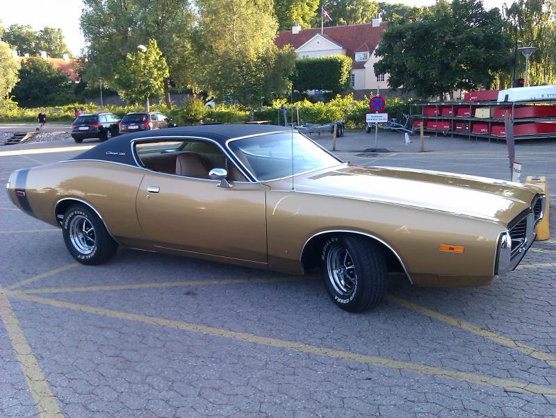

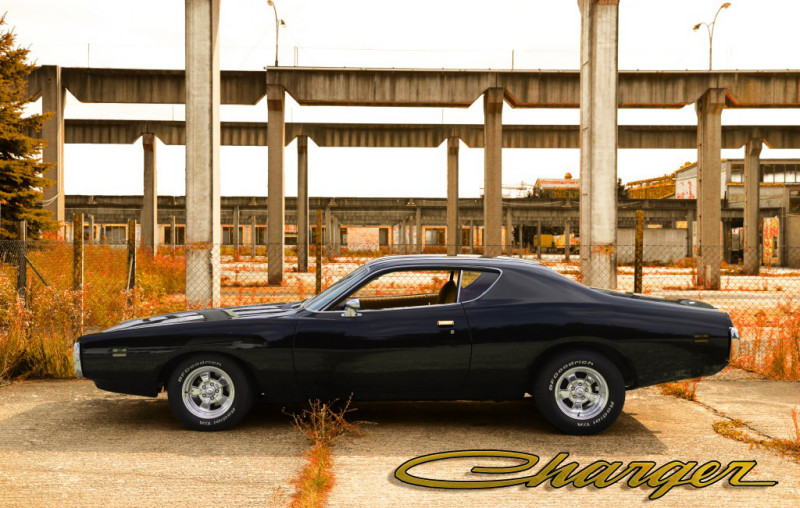

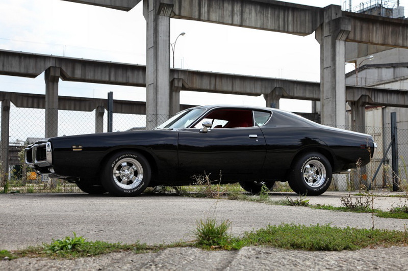

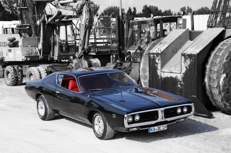

Hello,
my name is Michael and I come from Germany. My 71 Charger 500 has
Front 15x8 BS 4.5 245/60/15
Back 15x10 BS 5.5 275/60/15
The wheels/tires fits perfect without any rubbering or scratching at the body/chassis.
Excuse my bad english and I hope I can help a little bit. :headbang:
Here is the LINK for my Charger restauration....and I know...it´s German but the pictures will tell the story :icon_fU:
best regards
Michael

+1 with Michael
I have 15x7, 245/60 front and 15x10, 295/50 on a 5.5" BS rear on my roadrunner.

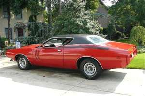

I have on my 71 Charger, 15x8 with 275/60/15 on the rear and 215/70/15 front with 15x7 rallye rims that are the Wheel Vintiques repo's.
I had to take 2 leaves out of the rear springs to lower the ride height. There is a lot of room under the wheel wells for the bigger tires.

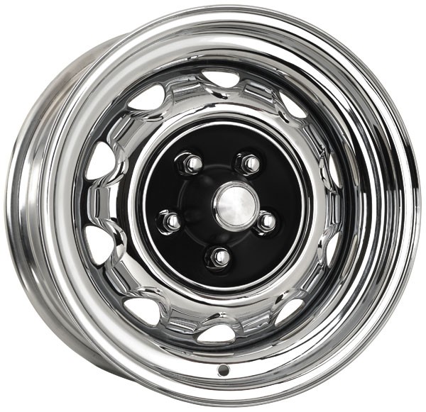

What are those wheels called and where did you get them?
