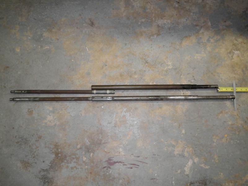

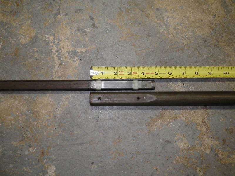

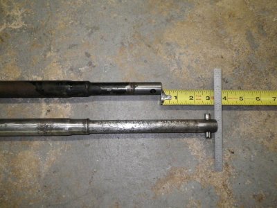

Hello all. I'm new to FBBO but not to Mopars. I figured I'd chime in since I just did the same type of conversion on my 70 Satellite but from power to manual. My 1970 parts manual showed two different part numbers, one for the p/s shaft and a different part number for the manual steering shaft. I found an entire steering column from a manual steering car but wanted to keep my original column so I disassembled both columns and installed the manual shaft into my column. I was interested in seeing how the shaft was constructed so I took it apart. I also took a few pics along the way. The first picture shows the 2 shafts, the shorter p/s shaft on top. The second picture shows the ends of both shafts as well as where the extra overall shaft length comes from. The third picture is a close up of the disassembled p/s shaft. I had to hit it pretty hard with a plastic dead blow hammer to break the nylon "buttons" and allow the shaft to collapse. The 2 little holes in the outer shaft are where the nylon was injected. There are 2 similar holes on the other side of the shaft where the excess nylon oozed out during the manufacturing process. You can see how the nylon filled the cavities in the inner shaft an attached the two shafts together. When I slid the p/s shaft back together it did not feel as solid as it originally was. I wouldn't want to use it in a car again, I'm sure you would be able to feel the wobble in the steering wheel.
