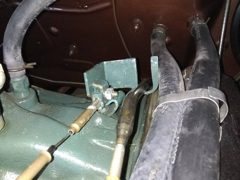

Anyone know where to find a throttle cable bracket for 64 street wedge Carter afb 3611s thanks nfcia53.
They are hard to find, but I would think all 4 barrel carbed B or RB brackets for that year would be the same. The 2 bbl brackets are different than the 4 bbl, because the 2bbl carbs are narrower, and it puts the kickdown linkage in a bind. When I switched my 64 from a 2 bbl to 4 bbl, I found a bracket on a 64 Imperial 413 in a junkyard. I had to make some modifications to it, but it ended up looking factory when I got finished.
You could start a wanted thread. Someone may have one for you.
