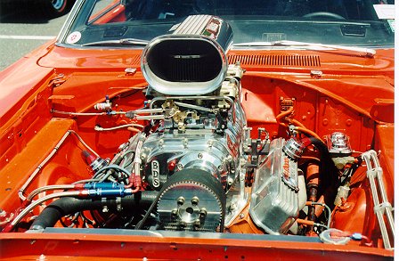

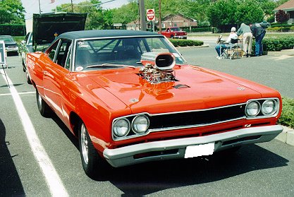

I had a Mopar Performance 440 siamese bore 440 driven lots on the street, no problems on the street. Would recommend high volume water pump, and a up to par radiator. Good luck. 68psrr5.jpg68psrr6.jpg
