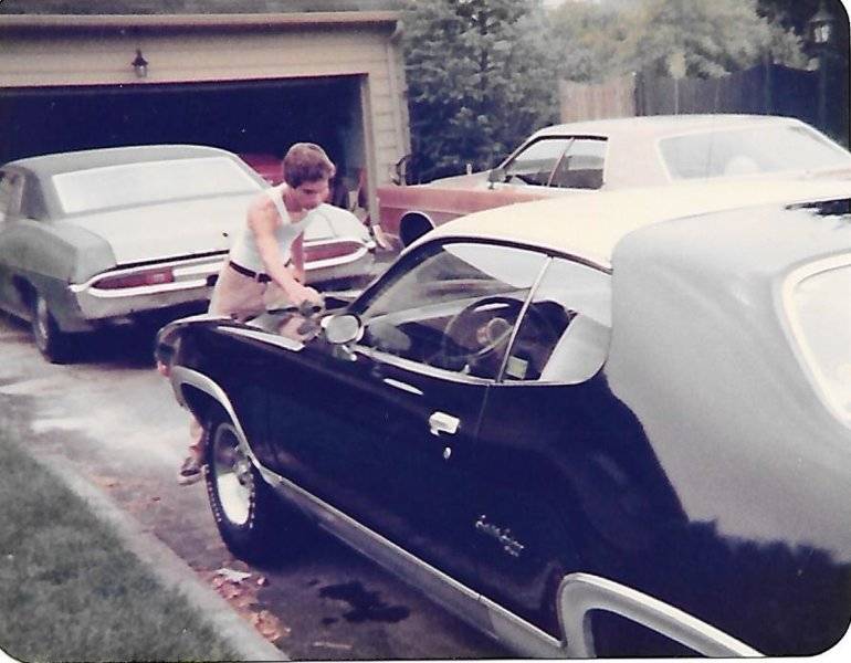

In this picture is my first 72 SSP summer of 77. I just bought from Original Owner with 21,000 miles. You can see the left 1/4 was redone because his neighbor backed into it about a month before I bought it. The argent that was used was much lighter than original when compared to door. The factory argent was as smooth as the car paint. Then in 2014 I bought another in original paint and the argent was smooth as the car paint.
