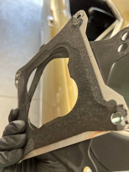

My car had a hot running issue, I found this junk under the carb. I’ll tell you this won’t cut it. A 3/8 fiber spacer did the trick, without any mods to the stock choke stat on a 440. Ive had to do the same thing on past rides.
