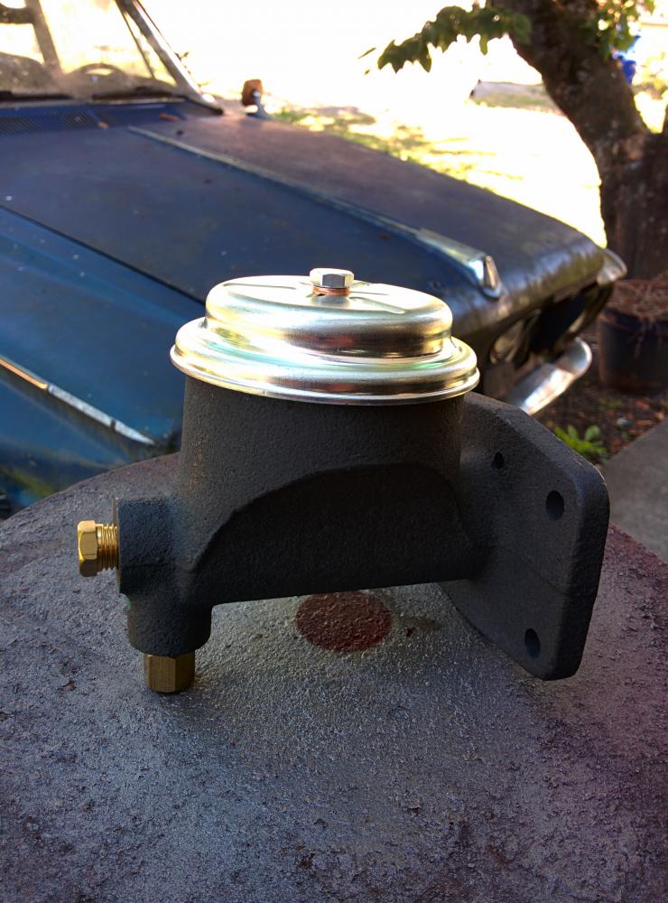

Picked up a master cylinder from the auto parts shop that has two outlets. Mine have only one and I was wondering if I can just plug the extra outlet before I do the swap?
1962 Dodge and it was the only option in their book. Any thoughts?
Andrew
I would like to see the master cylinder that they sold you. Is it a dual reservoir MC? If it is you cant just plug one side and use the other. Is it a power or manual system? The correct MC from NAPA is NMC M40963 for manual or NMC M37257 for power brakes.

Here's the one they sold me.
M36218

Figured it out. M36218 is the same as 40936 except with out the rod. I'll just plug the bottom outlet and I'm good to stop.
One port is for a Pressuer Stop lite switch. So you should be good to go if you plug that port off. My self I Don't like those masters as if you get one line blown you loose ALL your brake's !
Factory is alright by me. I've got an emergency brake.
Yep, that should work,but like wedge said, you might want to think about doing a dual master cylinder conversion later on. Much safer and fairly easy to do with the line and distribution block kits you can buy now. Several threads on this site and others about doing the conversion.
