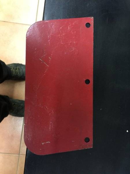

Was there insulation between the walleypan and intakemanifold on six pack engines cant find any info on this matter ?Did the six pack hawe the coverplate over the front of walleypan like the singelcarb engines ?

Ok thanks where there a coverplate that was held by the 3 bolts that holds the waleypan ?
Yes, there is a flat bar with 3 bolts in the front & the back of all big block valley pans...including six pack engines.
