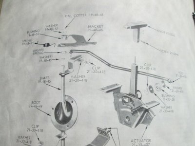

Is the linkage the same for this as a regular automatic or is there special "slapstick" linkage?
Linkage is indeed different, as well as the transmission brackets, and an additional transmission bracket is required on the tailhousing for slapstick that is not required for column shift. Sorry for the incomplete page, but it's the best I have on this computer at this time.
