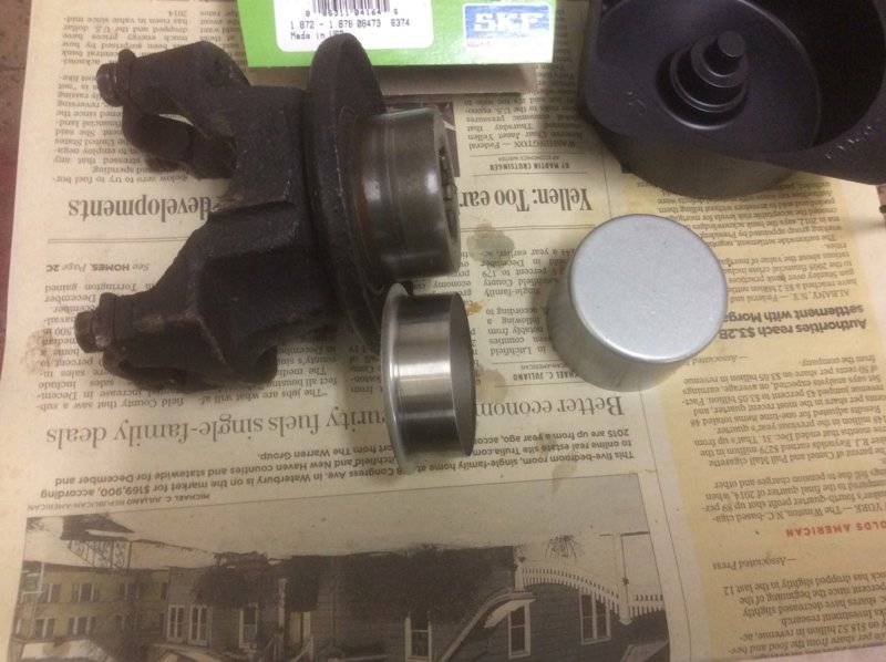

Does anyone make a sleeve for the seal surface for a 741 yoke?
I had a 727 yoke that was rusty and asked the tranny man if they make a sleeve for tailshaft and he said no. He then took my rusty looking yoke ran it on a lathe and it came out perfect, clean as a whistle.
It's been awhile but I got 'em from Year One.

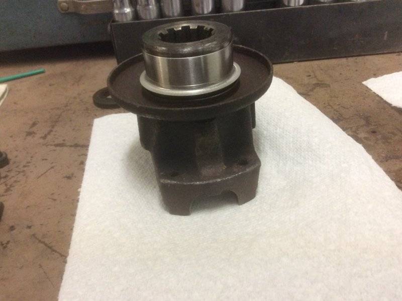

Think this is it. The gray cup drives it on, use a block of wood on top of it. It will dent because you need to hit it pretty hard.
https://www.ebay.com/itm/Chrysler-M...r-sleeve-speedy-sleeve-with-tool/183799986628
Take the yoke to kaman bearings in Tucson. They have sleeves for everything.

Thanks Mark, the one I have I would have swore would have not leaked after I got done with it. It had once tiny pit in it but I guess that it lined up exactly with the seal lip..... I'll let you know.
