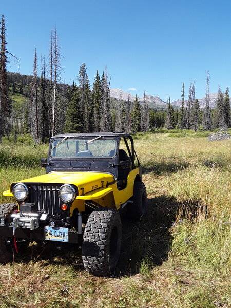

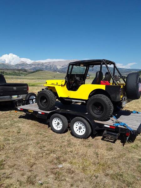

I have used Advance Adapters and Novak Conversions out of Logan Ut , Both are good . Do some research about complete drivetrain compatibility , some combos work a lot better than others . My '49 cj3a has 4.3 v6 , th350 , custom dana 44's , 6 inch body/frame extension etc.....
