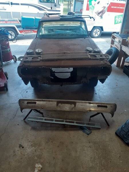

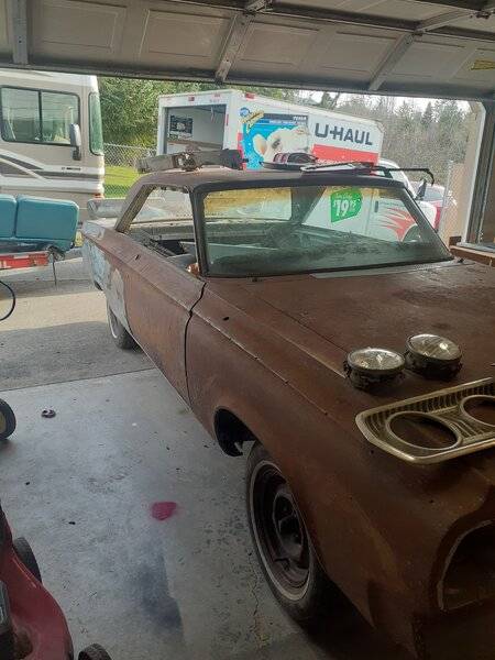

Thanks for the advise. I uploaded a couple photos
The problem I'm running into with finding a parts car is that everyone with a 1975 and older car thinks that it is worth its weight in gold. I dont want to pay $3500 for a rusted out 72 4dr dart with a donor v8 that I still have to build
