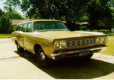

This wagon started life as a 318/904 with p/s, p/b, and a/c. When done it was a 440+6 and 727 with all the power options still intact. Just motor plates, different drive shaft, exhaust, and stretched about 3 wires under the hood.
