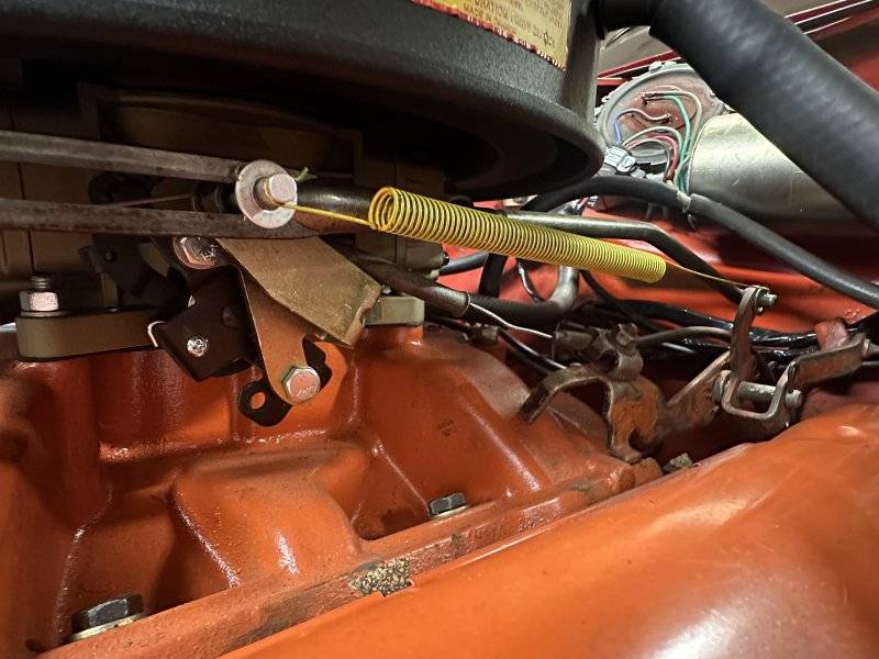

As the title states, I'm installing a sniper 2 onto my 1969 Dodge charger.
The plate and post, I guess you call it, from my carburetor does not seem to work on the sniper setup.
What is everybody using for the throttle cable and kick down on b-body? I did a search and only found results for an e-body.
Thanks in advance!

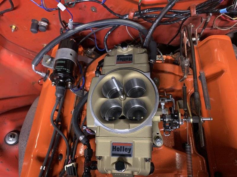

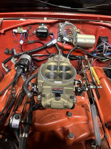

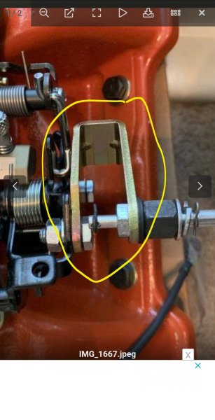

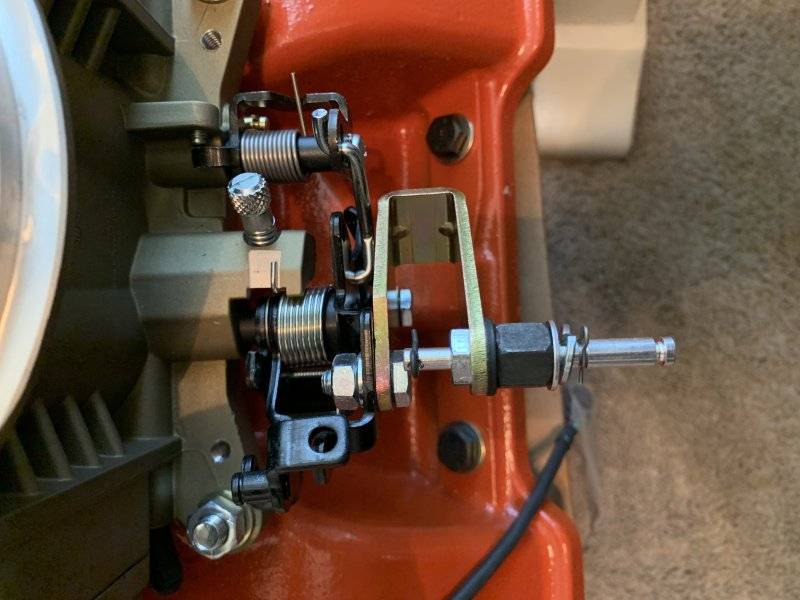

I’m running the Sniper Stealth EFI, on a CH4B intake, and using stock linkage, with the second adapter.

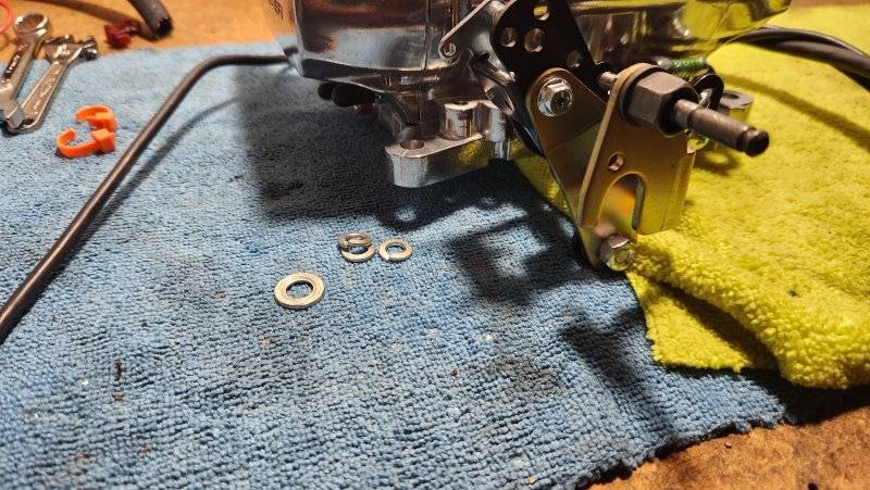

More showing the washers on the lower bolt for alignment.

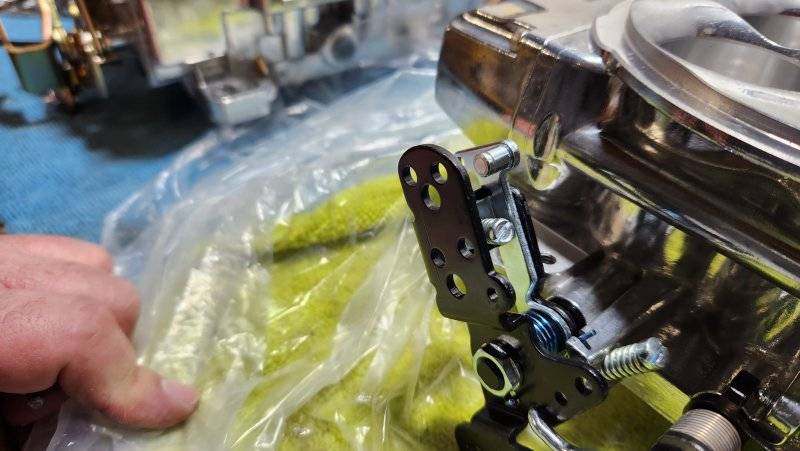

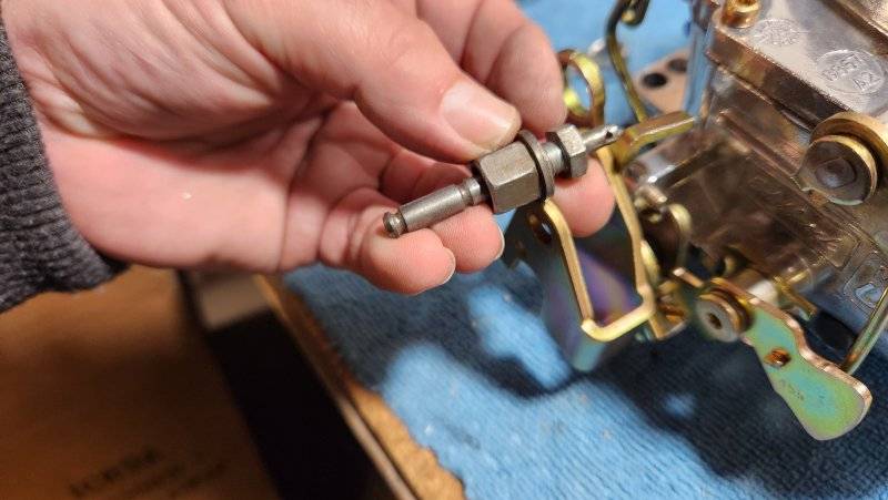

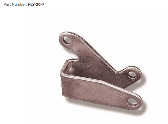

I found this laying around. Seems to work. Will test for on the car ASAP.

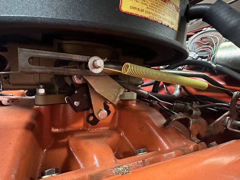

For anyone wondering, this is a Holly carburetor for b body Chrysler. For reference, I have a 440 with a 727 transmission.
