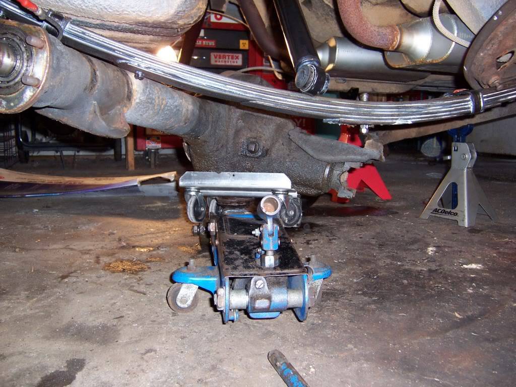

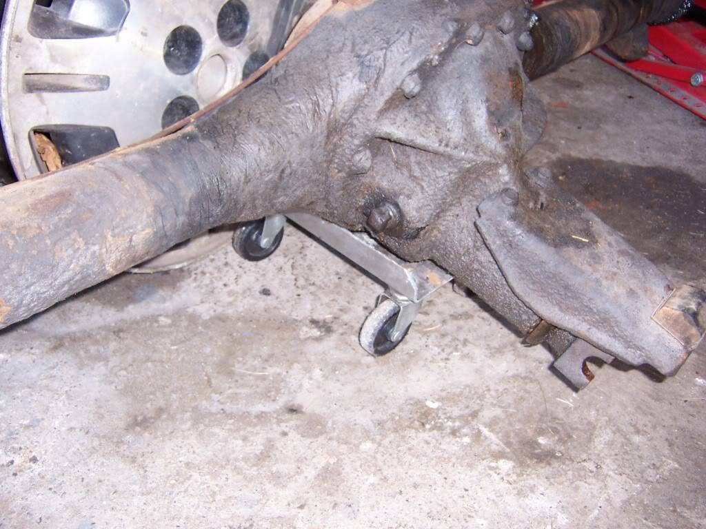

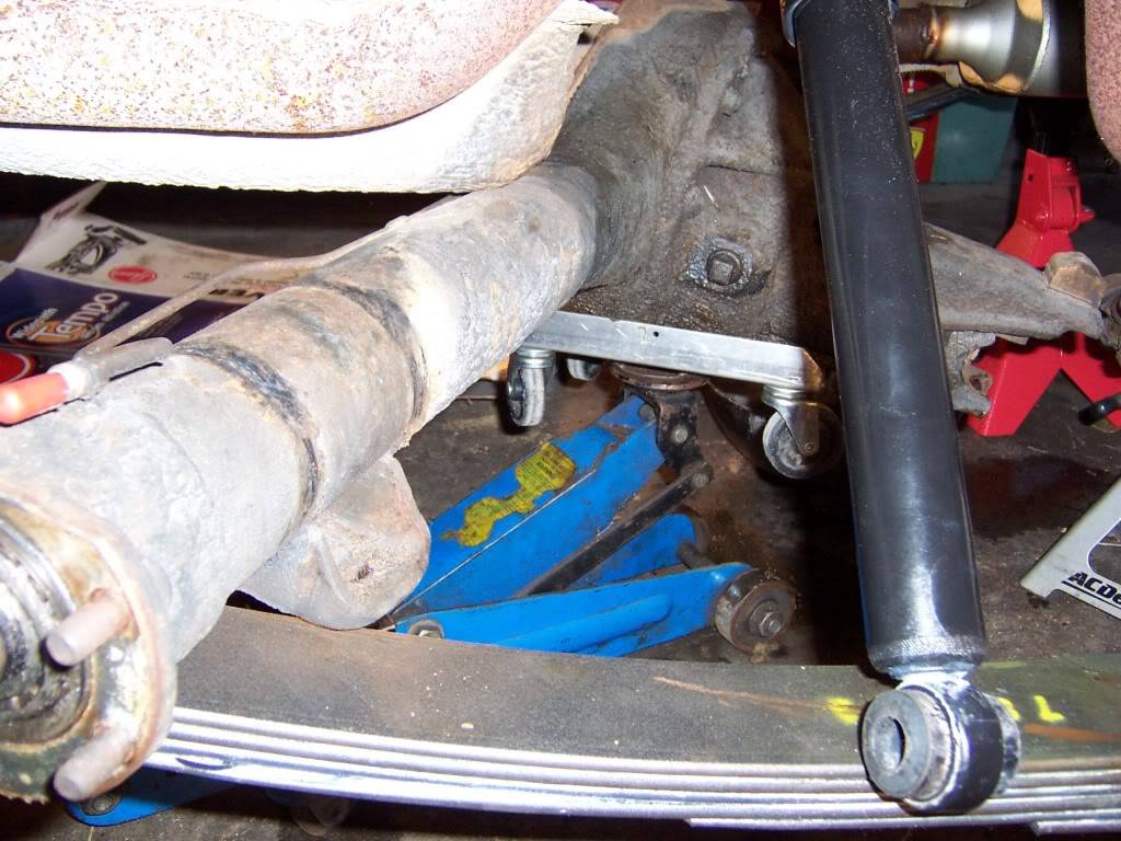

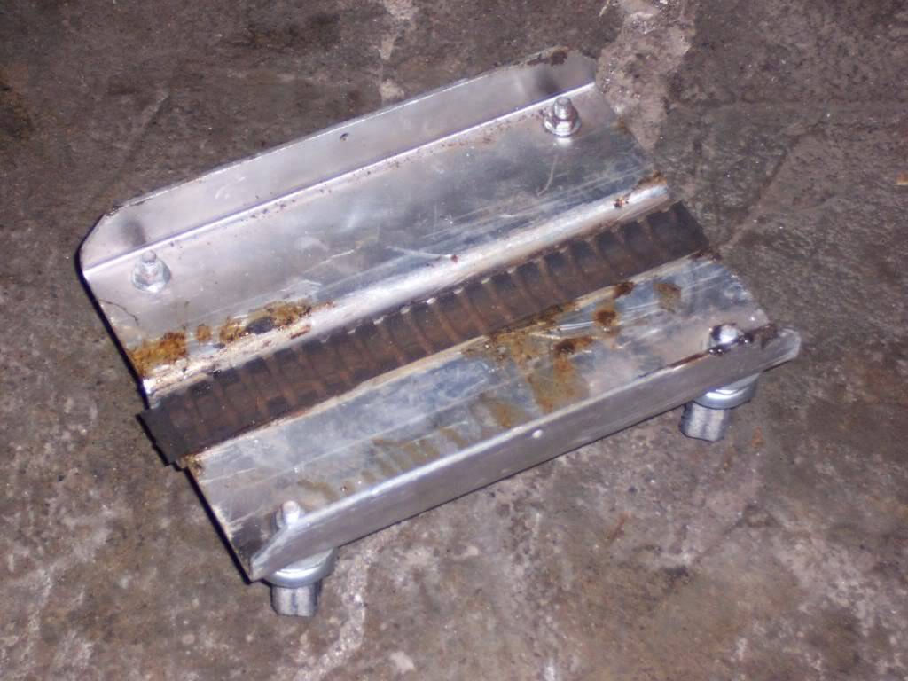

Now,for the "cave man" part of the day. I needed to remove the old rear axle,and since I'm an independent cuss who works best alone,I knew it would be a bit tricky. I had a floor jack,but I knew the balance would be an issue,especially when twisting and turning the housing(complete with axles and center section) to clear the springs and such. Looking around,I found this:
A dolly for moving snowmobiles around(this goes under the front ski);fit under the center section quite well:
After some twisting and turning-remember,the fustercluck factor was high with this heavy-*** thing:black_eye:-I successfully removed the offending unit. I took this as a good sign-sort of a "the car likes me and appreciates what I'm doing" moment.:grin: That dolly also helped moved the unit to another part of the garage.

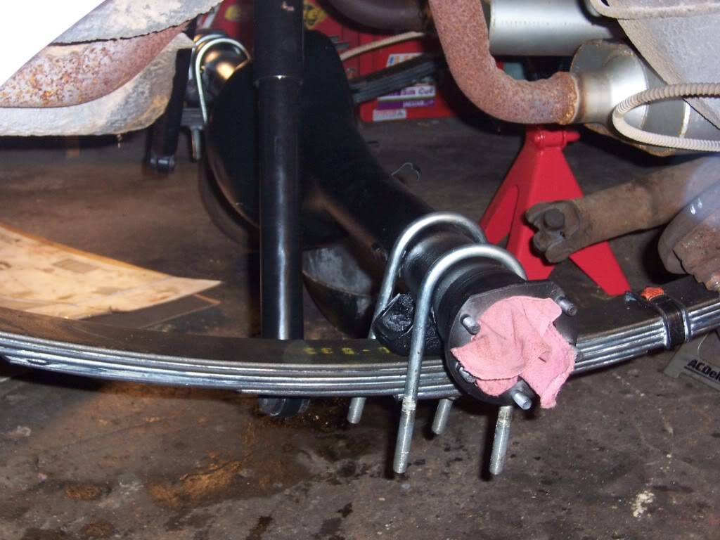

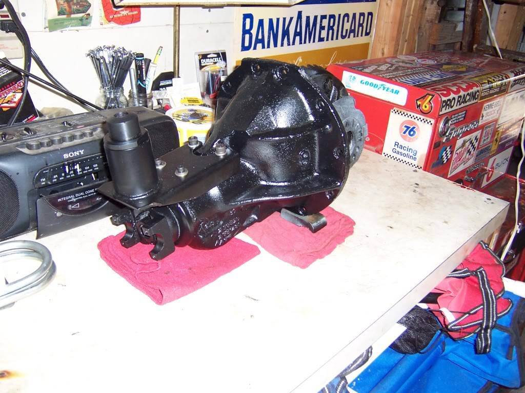

So,the new,cleaned and painted housing resides on the springs,and when the paint dries on the spring plates and other things,I can install the other center section,axles and such.
So,even a Polack with single eyebrow and Cro-Magnon tendencies can wrench on a vehicle. ...And,not end up in the emergency room.
