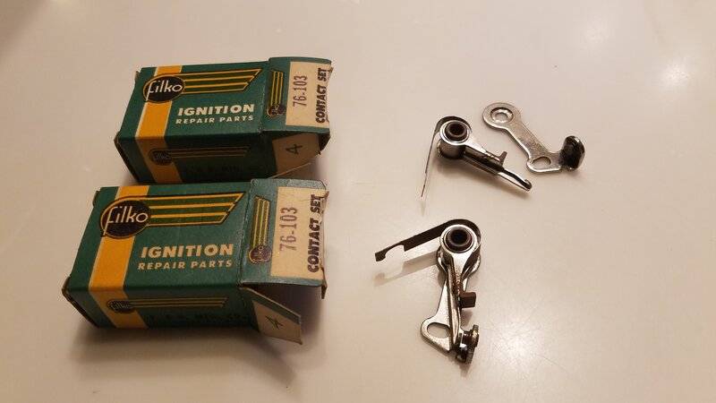

Exactly! New tune up parts from the store are junk. Condensers being the worst part of all. @HALIFAXHOPS has a bunch of new old aftermarket parts that are top quality that he sells.

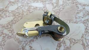

Points, rotor, condensor... points,rotor,condensor... points,rotor,condensor... etc.etc. That was THE routine tune-up with plugs we did a billion times. Wonder why ? That's why they evolved to electronic ignition. Unless it's a big $$$ car, trash it and convert to an electronic setup.
If the condenser works leave it in there when you change the points till it doesn't work. Halifaxhops is the bomb!!! No reason to not run points
