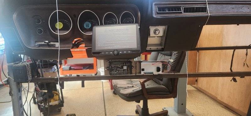

So where is a good place to install the controllers?
Paul_G
12:00 AM
Dec 24, 2013
2,221
3,708
Surprise, Arizona

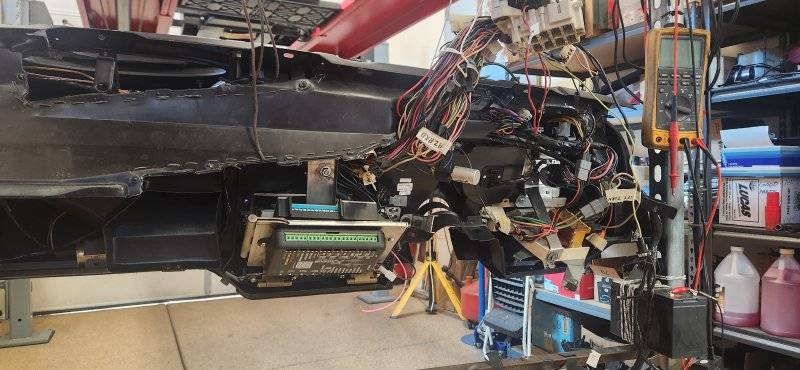

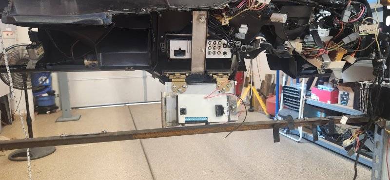

I have a Dakota Digital cluster module and a TCM430 trans controller to hide somewhere. I am not using the factory radio, I have a single din unit in its place. That freed up some room. The contollers need to be accessible so this is what did. They unfold and come down.
