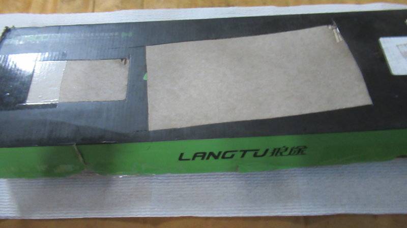

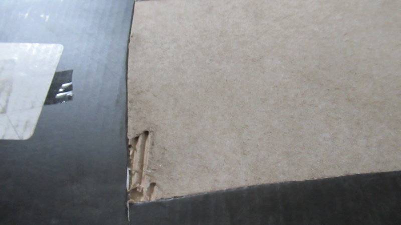

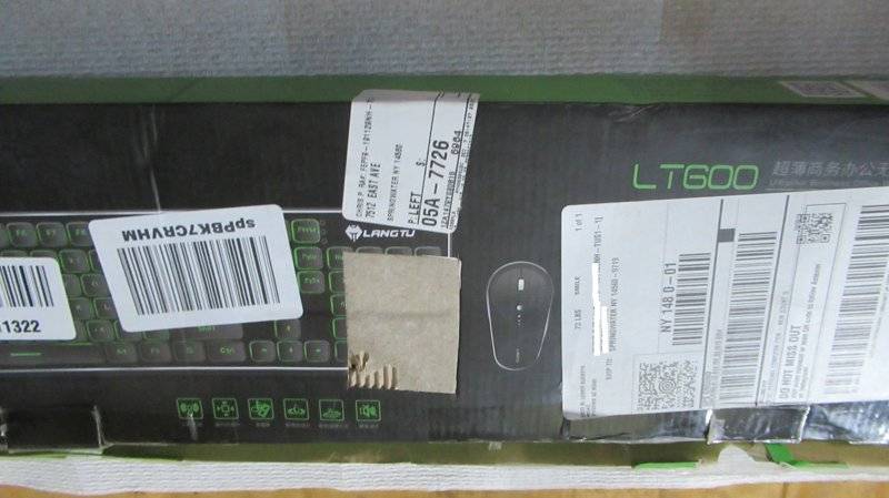

ripped open,clearly taped together and hey its got missing box area from Prior shipping labels.

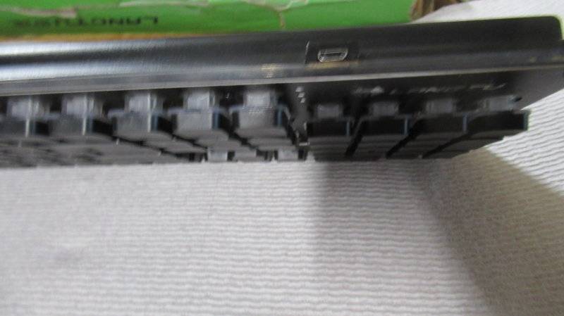

i take this kb all apart and yep the charge port is literally laying inside the case.
i look at it its got Tiny little holes for 2 even Tinier prongs...
looks like they didnt put enough solder in the original holes at the factory.

i had to lay the solder on the prongs and then clamp it on the board and resolder from the top and Pray a Lot :praying:....again,Ty Lord.

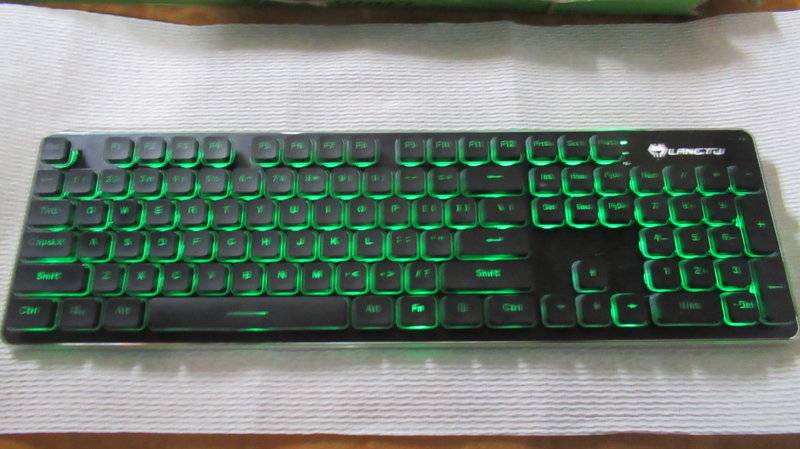

the last pic is after ive fixed the port and now have a working kb with a working chargeport.
